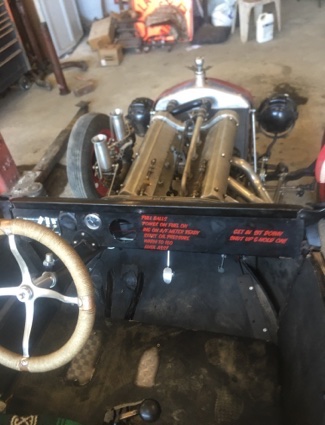

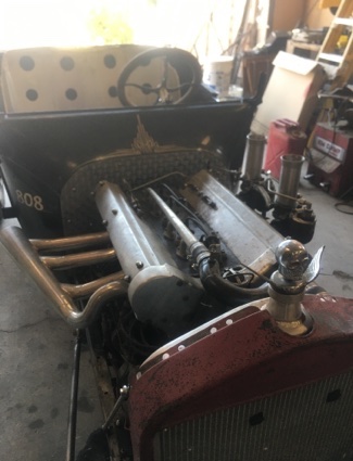

Here’s a DO Rajo. Cam train and covers are custom made. Wicked fast. It will daylight the left front wheel when you grab second gear at about 5500 rpm. We will be racing it at Santa Margarita next month.
- Attachments
- 49D820D1-34E5-4664-B794-70FE16C2CE69.jpeg (53.24 KiB) Viewed 2186 times
- 3F3F41FE-ADF2-491C-8D9D-990FE1EE0E5B.jpeg (48.35 KiB) Viewed 2186 times

Re: Please help me out with some values of this car
I’m sure it would. I can run 50 in my dump truck as is. This thing is capable of more than twice the rpm it can reach. But that big vertical windshield would be holding it back and the part about swapping reliably for performance suggests a more low key approach.
