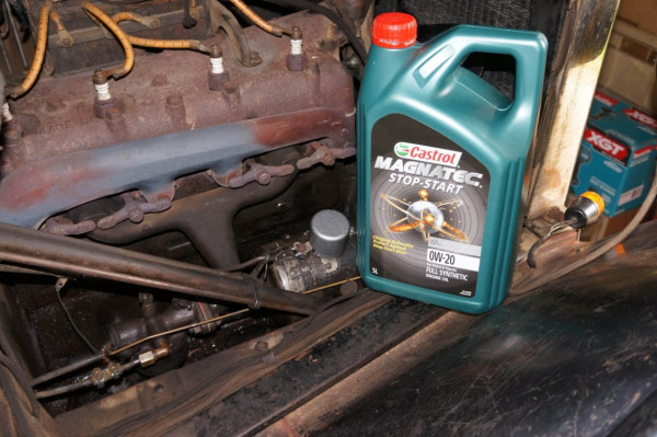

Yesterday I drained the clean oil out and replaced it with this oil. Went for a 10 mile run to get the oil splashed about and to ensure the brakes/reverse etc worked correctly (and they do) and this morning the problem has gone away.
Handbrake on, all 4 wheels on floor, 2 cranks to prime it then key on and fired up first crank.
I'm sure some will say you shouldn't use this oil .

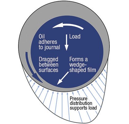

Viscosity is not necessarily a good indicator of an oil's film strength. Ford warned against using thick oils and against any oil that did not have a low cold test. Ford recommended a quality oil with a low cold test that would correspond to what we know as 20W or 20W20 today. Modern synthetic 0W20 meets that specification nicely, having a VERY low cold test, very high film strength, and proper viscosity at operating temperatures, and other beneficial qualities that were not obtainable in the 1910s and 1920s. I believe that Ford would have recommended a multi-grade oil, had any such thing been available. All that said, a 10W20 or 10W30 full synthetic might give similar results to what you are getting with 0W20 as far as cold performance. Based on my experience, and of that of others who run the heck out of Model Ts with stock engines, either oil is suitable for a T engine in good condition. If the clutch is gummy from disuse, or if it is new or rebuilt, some run time might improve its performance.

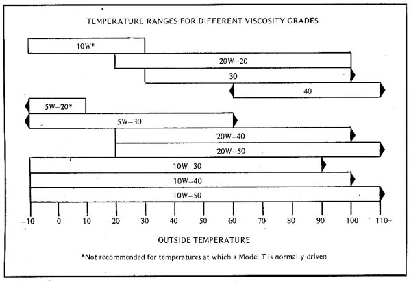

According to Ford, normal weight oil for a T would be a high quality 20W. 0W20 synthetic oil gives good service in small displacement engines making well over 1 HP per cubic inch and running at high speeds and temperatures. These engines have high loads acting on much smaller bearing surfaces at much higher speeds than are found in a Model T. While these engines do have oil pressure to many critical internal parts, they do not have oil pressure to all highly loaded parts.

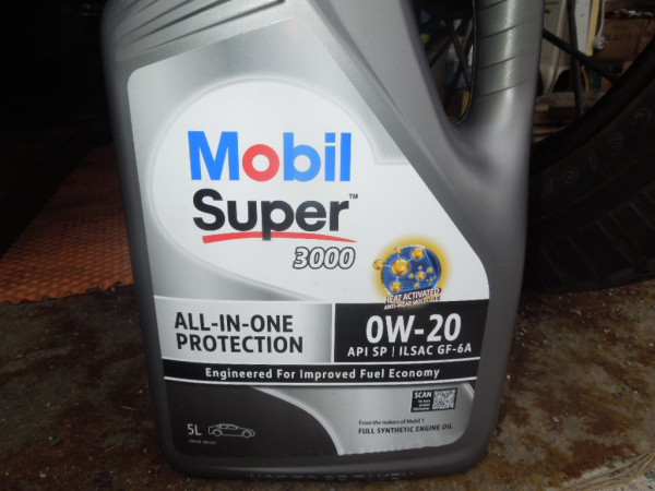

0W20 is hideously expensive; (nearly $70 for 5 litres) but I'm going to give it a go. (Due for an oil change anyway). I just don't believe there's a mechanical issue with my clutch either, since it's a 26 with lug shoes, and it's a low mileage car. It's purely a winter problem. In summer it will start without jacking up the back wheel on the 3rd crank.

JohnH - I got mine from Supercheap auto when it was on special for about $50. I used exactly 3 litres which took it just under the top petcock.
A 5L pack, so I still have 2L for the next change.
But if I knew how successful it was going to be price wouldn't have stopped me even if it was $100.

10W30 seems to be the most widely used oil in this area, and the most likley to be available at a discount. I use a lot of 20/50 conventional oil in old engines because it has been cheap and does a good job. I don't think it's the best choice for a Model T. The Model T seems to thrive on synthetic multi-grade oil with a low first number. As for lubricating efficacy, 0W20 synthetic is commonly used in very high performance modern engines with extensive factory warranties. I have an Arctic Cat SXS vehicle with a 950 cc V-twin engine that makes 93 horsepower at very high RPM. The factory recommends a 0W20 synthetic oil. This vehicle has a common sump for the engine and 2 speed gear box and employs a wet clutch driving a CVT belt drive. Vehicle weight is around 1600 lbs unladen. It's also worth noting that automatic transmissions have proven to be very durable over many decades running a very light bodied lubricant. They handle high horsepower at high temperatures and have highly finished parts operating under extreme loads while sharing lubricant with bands and clutch packs.

This is very interesting. I'll try some out in my car at the Australian Nationals in Dubbo next month.
I see Supercheap Auto has Mobil Super 3000 0W-20 5 litres on special at the moment for $51.69.

There's an interesting article from Royce about engine oil here https://modeltfordfix.com/care-and-feed ... el-t-ford/
0W20 is actually recommended for very cold weather 0-40F (-18 to 4C).
I only drive at 0 degrees C about once a year.
5W30 is recommended for average use 40-110F (4 to 43C). That is exactly the temperature range I drive in.
So, 5W30 it will be, once I've done a bit more cleaning. But it is reassuring to see that 0W20 isn't going to destroy my engine.

And it gets better!
Yesterday from cold I turned fuel on and waited 30 secs, gave the Hack 3 1/4 turns with choke out to prime, set the levers & turned the key and it Free Started!
Unbelievable its the same car. From having to jack up a wheel to start the motor then leave the motor running for at least 5 min before neutral could be achieved to allow lowering the jack to not only an easy hand crank when cold car but a free start.
I tip my hat to 3 things now -The Ladies, The Rose of San atone and the 5l Pack of 0w-20 lol.

Conversely, I would be interested in reports about damage from actually using 0W20 or 5W30.
I haven't been able to replicate your free start just yet, Kevin, but it was an easy crank start this morning. Now, I'll go out for a drive.
So, I'm more inclined to look at experience and practical results when deciding on something, which is why I'm keeping an open mind on the subject of oil.
By 15 million cars, one could be confident that Ford knew what was best, and when oil is mentioned, 'light' is their preference.
It's been interesting going back over all the forum posts on oil types which people have used in the modern day. Aside from this present thread, 0W20 and 5W30 do get mentioned.
And in none of these posts, has anyone said, "I put (insert grade of light oil here) into my car and ruined all the bearings". There's one or two mentions of a rod bearing failure after an oil change. But guess what, my one and only rod bearing failure occurred after putting in 20W50!
What has been ecouraging is the reports from those who have used light oils for many years without requiring any bearing adjustments.

The oil chart from the MTFCA engine book indicates that 5W-20 is not the same as Ford's recommended 20 weight, and is not recommended for Model T use. Is it wrong?

Re: Transmission binds when starting cold-Update...Fixed
I think that the point of very low W is some what miss-under stood. Penrite oil chemists cover it so basically all should understand one of the few problems it presents.
Veteran and vintage engines have requirements that differ from modern technologies and tolerances.
Modern thin oils designed to circulate quickly through an engine and drain from internal surfaces back to the sump. This happens also when engine is idle (switched off)
75% of engine wear is on a cold start, Penrite put it simple, Thin starting point of multi grade oils will give.
"LITTLE PROTECTION TO THE PARTS ABOVE THE OIL LEVEL" a dry start
The way a splash system works the oil differs from that of a pressurized system.
I rebuild many T engines and never the same one twice. 15W-20 to 30 for a fresh rebuild and 15W-20 to 40 for normal conditions and 20W-50 for high mileage, that suits normal T driving weather.

The debate is mostly based on one side by opinion and not the understanding of today's oil in old design bearings.
First, a splash bearing relies 100% on hydrodynamic lubrication, meaning that shaft to bearing pressurizes the oil in a wedge between the faces.
Now the oil, A multi grade oils does not get thicker as it gets to operating temp. all oils thin with heat but a multi grade formulated with additives to act like it's thicker under pressure, a higher viscosity oil has been measured to get up to 600+ PSI in a hydrodynamic lubrication system.
Now a 0W starting point, an oil that is designed to move fast for modern engine specs which can be less than 1/2 of a run in model T.
For a 0W-20 to get the oil to act like the 20 it must get to operating temp to do so. A O oil will have trouble to be able to float the bearing surface from the shaft to create the hydrodynamic pressure required, it's thin and simply is just pushed out of T bearing clearances, it needs to get hot to get close to a 20 to do any good.
So by engineering standards the 0w oil on a cold engine splash system is running metal to metal until it's able to generate enough heat to lift it's viscosity. So Henry had it right , a 20 to work from a first start.
