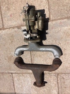

Re: Steel vs Iron
I have had good luck brazing cast iron. Cool slowly by backing off the torch heat until all the red is gone.
See dual NH carb setup. The intake was made from 2 stock intake manifolds brazed.
