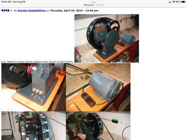

Bob.. I miss him too.. I believe he was noted saying hand crank coil tester should not be faster than 80 revolutions per minute.... the same speed as a Edison diamond disc record.

I miss Herms comments also and I agree with his HCCT rpm too,....n
