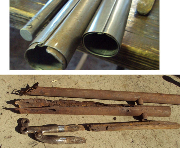

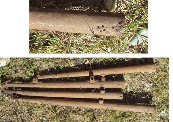

What jsaylor said. Here is the technique used on my 1912 Flanders 20.

Those irons are usually double walled. Condensation works in and the two walls plus the wood let it stay wet and rust things. More so as the water runs down. The upper part is likely less rusted than the lower part. You might want to see if there is any rust coming through at the lower parts before you do much else. They are the weakest where the sheet metal tubes are brazed or welded to the bottom stubs. Many have restored bows that looked good on the outside only to have them collapse later because of rust. I hope that isn't the case with yours but examining them could save some problems.
Mine had wood filler pieces between the bow end and nearly to the bottom. The bows go into the sockets about 4 to 6 inches I believe.
Toothpicks and/or epoxy should work well. Try to get as much inside as possible.

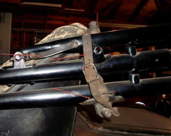

Are you talking about the screw that holds the leather strap and key/pin on the top socket?
Here is a photo of my 1917 roadster top sockets that I recycled from another post (the reason for the arrows). The top most arrow points at the leather strap to which I am referring.
Be aware that the original, factory screws are squared-off just under the screw head. This keeps the screw from spinning around in the leather strap and subsequently prevents the screw from backing out of the top socket and, ultimately, prevents the loss of the screw even if the hole in the socket or screw threads are stripped.

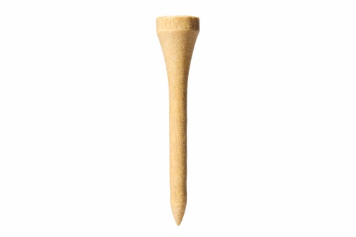

An old woodworking trick is to use wooden golf tees. They are great because they are tapered and can be driven in tight. If the tee has a varnish finish, run sandpaper over it so it it bare and roughed up (so the glue will adhere to it). If the hole is rather big, then cut the pointed end off so the taper of the tee will fit tight in the hole. Fill the hole with Tightbond wood glue and drive in the golf tee so it is tight, but not so tight as to split the wood. Let it set a couple of days, cut off the head of the tee and redrill the hole to the proper size of the screw. Jim Patrick

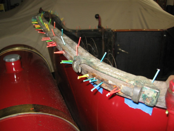

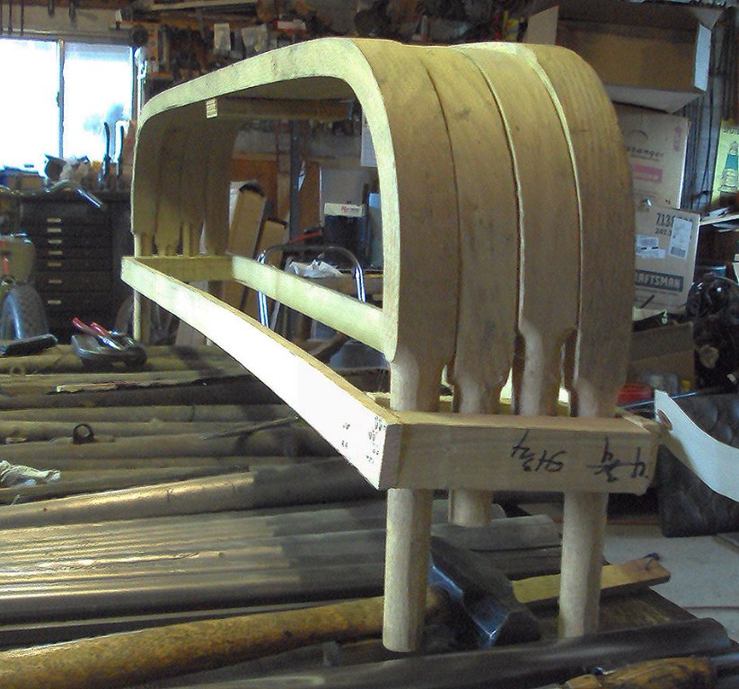

Just two more thoughts, you asked how far the wood goes down into the bows. Here are my new '14 bows.
Also, I noticed that sometimes many holes were made for the tacks or nails in the area I believe we are talking about.
I wasn't exactly sure where the Hole you mentioned was located but assumed it was at the top of the iron. If so, maybe simply relocating it would make it more solid.
