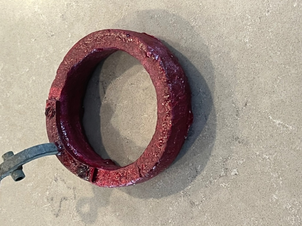

I made this new cork float for a 1912 Holley and sealed it with Red Koat tank sealer. Claims to be alcohol and additive resistant.
