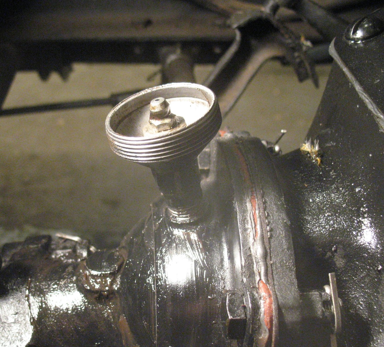

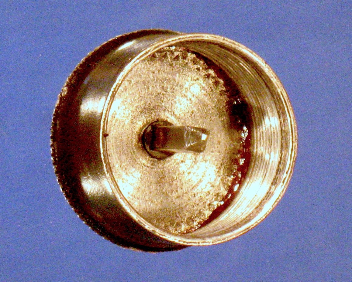

Greasing the universal joint the original way can take forever, so I resorted to this.
Even with a zerk in the cup it took a lot of strokes to fill the cavity, but it was a lot less tiresome than the old way.
But the post in the cap won't let it screw on with the zerk in place. If I shorten the post, is there any reason that will be a problem later if I want to go back to original? I can't think of any, but that thing must be in there for a reason. Opinions?

Can you use the cap from the one you removed (or extra one laying around)? I use a number of the zerk kind and have never seen one with a post in it. Also, do you pull the cap and fill the cavity completely? I usually just give it a couple of pumps from the gun.

The "cap" I am referring to is the one to the left in your picture (on the axle tube). Not the cap for the grease cup.

It's been a while since I've had it off but I believe the universal joint grease cup on my unrestored '17 roadster has a post inside the cap. Can't remember if it is square like Mr. Jelf's.
There must be a reason for it, otherwise it wouldn't be there.

The cups I have had with the square post also have a type of spring in the body of the cup. This spring clamps around the post and prevents it from working loose.

I have a shortage of big grease cups. Of the three I have, the ones on my runabout and touring both have the square post. The one on my 26 RP project has a zerk and the square post cut off. Apparently it's a pretty common feature. My guess is that it has more to do with Ford getting small parts from different suppliers than it does with the year.

After reading Jim Sims' post, mine does have the spring.
Thank you for refreshing my memory.

Since greasing the universal in not a daily thing to do, you could just remove the zerk and screw on the cap with the post in place.

If I want to grease the U joint I unscrew the large great cup and screw in a zerk fitting and get after it with a grease gun. Much quicker and less messy. I then replace the the fitting with the large grease cup to be more original.
I guess I ought to screw in a zerk fitting in the greas cup. I just have never done it. This idea was in Tinkering tips years ago. Or it may have been an articl about it in the vintage ford mag.

I install a zerk and leave it. The only one that knows it's there is me and frankly, I don't care what others might think.

My universal grease cup does not have a spring. I have a spare torque tube that had decades worth of hardened dirt over the grease cup. There was so much dirt that you would not know what was under it if you don't know Model T's. After chiseling off the dirt and removing the cup, there was no spring in it. Was the spring installed during manufacture or was it added later? Should I be concerned about not having a spring?
Topic author - Posts: 7395
Re: Grease cup: OK to shorten the post?
Yes, and only use NOS grease. Failure to do so will cause your timer to run backwards (except south of the Equator, of course).
