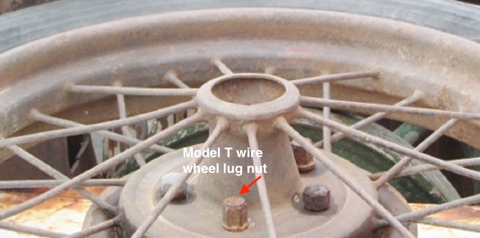

Being a total moron could someone post photos of the two types of lug nuts in question.

Here is T wire wheel with correct style lug nut. Two of the others are impostors :lol:
