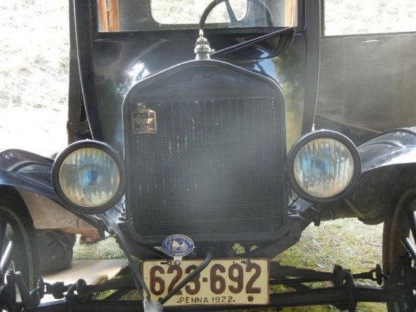

Any one know of a source for blue tinted six volt head lamb bulbs?
I need to find spares and a replacement for the 1922 Coupe.

Some time one has to look under a different rock.
Markings long gone. So a shotgun search of internet and ebay turned up two NOS listings. Identified as 1132, and product names of Imperial and Security. Ordered a set. So I should be set for a period of time provided the bulbs have not deteriorated.
Checked Dykes electrical/lighting section no number for bulbs 1132. Thanks for the suggestion and interest. I did see an early Wards catalogue listing for Blue Tint Bulbs, nitrogen corrugated blue?

Be careful with that. Most states and locations dont have it as legal to use blue headlight bulbs. Now you are driving a Model T so you probably won't get pulled over.

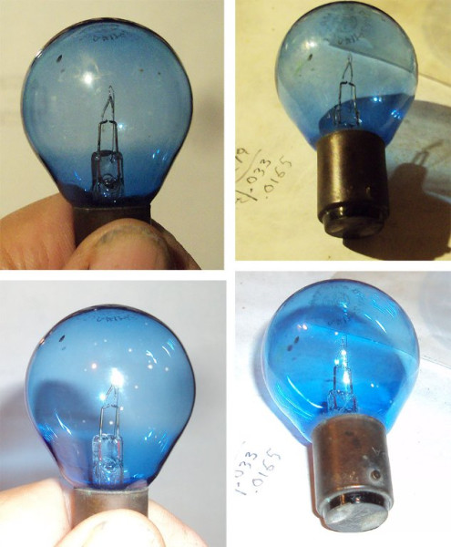

The blue bulbs are a delightful thing. I took some photos of mine to show those who haven't seen one up close.
I thought I had a box of them but haven't found them yet. I'll keep looking.

This is not a head light bulb. Notice the single filament. Note the 2 contacts. these are + & -.The pinned brass body is not a ground.
This is an old spotlight bulb.

If pinned body is not grounded then that would suggest wiring in series for a non-starter - magneto bulb.

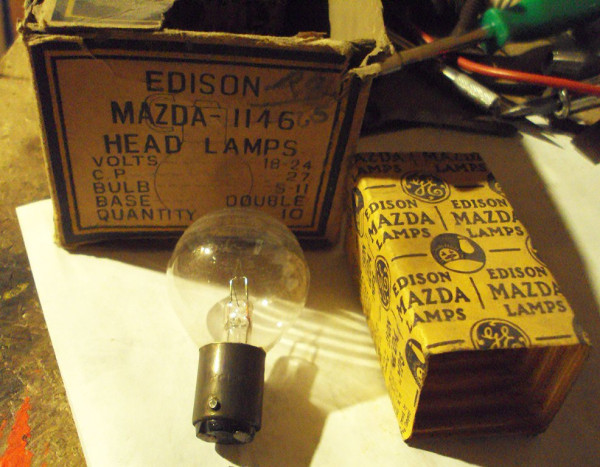

Thanks Frank. I have several boxes of clear ones like that and the box is marked Headlight Bulbs. I had thought they were Mag bulbs also. Sorry if I have confused anyone.
