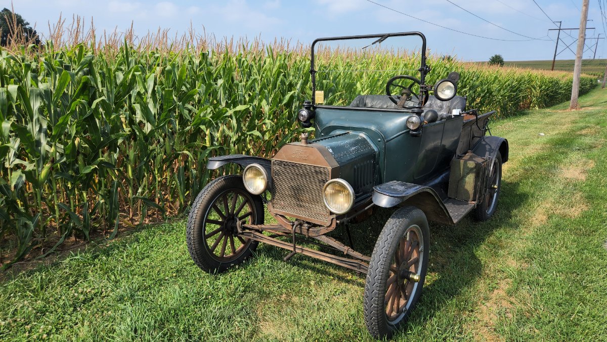

Had a nice drive today in the old T and stalled it when I got back to the driveway. I hit the starter button not thinking the switch was in the Meg and not BAT position. It fired righr up. Any issues with starting in the mag position on a car with a starter? Just looking to learn. Thank you.

No issues as long as it starts readily on magneto. If it requires a lot of cranking, best to use battery. It may start more easily on magneto with the spark lever advanced a few notches. (Nice picture!)
