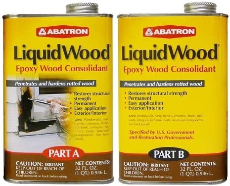

If you would like to treat your blocks so they will not deteriorate and will last forever, the best product to use is a 2 part epoxy called “LiquidWood” mfg. by Abatron (www.Abatron.com). It is also available from Amazon. It is available in several sizes depending on how much you need and your budget. I usually get the quart kits as it has a long shelf life. Once part A and B are mixed together in a 1:1 ratio, it becomes a clear liquid the consistency of water. It is painted on the bare wood and soaks in. The more that is painted on, the deeper into the wood it goes. This must be done as many times as possible because once it starts to cure and harden, no more can ever be applied. Once it totally cures, it turns to a rock hard plastic that protects the wood as deep into the wood it goes and does not change the appearance of the wood. I use it on my Victorian house to halt and stabilize dry rotted wood parts, such as window sills and sashes so they do not have to be replaced. It is also great to preserve dry rotted parts on the Model T. Especially compound curved body wood that is very difficult to replace for anyone without woodworking experience. Jim Patrick
