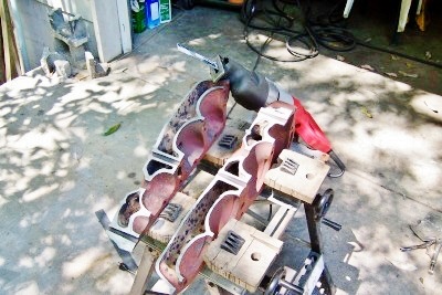

Generally, getting to the surface areas inside the cylinder head is a difficult process, just too many nooks and crannies.
Have used frayed wire rope, 1/4' dia. on a power drill, into the water outlets, and run it around inside, got some stuff loose and out. But can't see how sandblast would be of help. Likely just a chemical soak, maybe in a molasses bath!, would get most of the rust to flush away.
Treating the surfaces inside would be difficult, would be shame if surface treatments or layers of any kind causes poorer transfer of heat from the coolant.
Over time that iron head is just going to corrode inside, probably most are now rather deep pitted, and you can only do yearly maintainace by flushing, and cleaning the block and head to get rust flakes out, and preserve with good coolant mix, that includes rust prevention.
