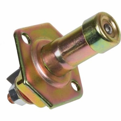

Hey Bob.. if you go over to Tractor Supply they'll have that on the shelf. Keep the bracket, just replace the switch and the plunger.
Posts: 7266
Re: Starter Button
Post by Allan » Wed Aug 31, 2022 8:04 pm
I would advise searching out a much more reliable original than any of the later replacements, which are prone to failure and safety issues.

Original Ford starter switches have become quite rare... And the replacement modern versions have been very very inferior with use as they tend to heat up very quick and the contacts weld together. Yes, the starter switches available as pictured from Tractor Supply may not be the greatest compared to original Ford starter switch, yes they will fail in time, but in my opinion are the best ones to have for replacement in the present.

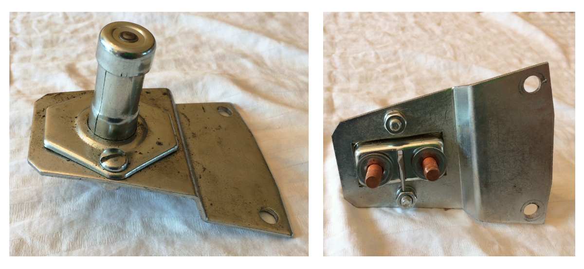

Time to think out side box and fit a square peg into a round hole. Time to do what has kept the Model T Ford operating for over 100 years. Farm yard blacksmithing.
Model T replacement starter switch - from a supplier.
Starter switch found at/with a tractor supply source.

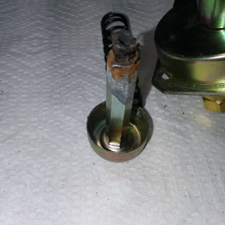

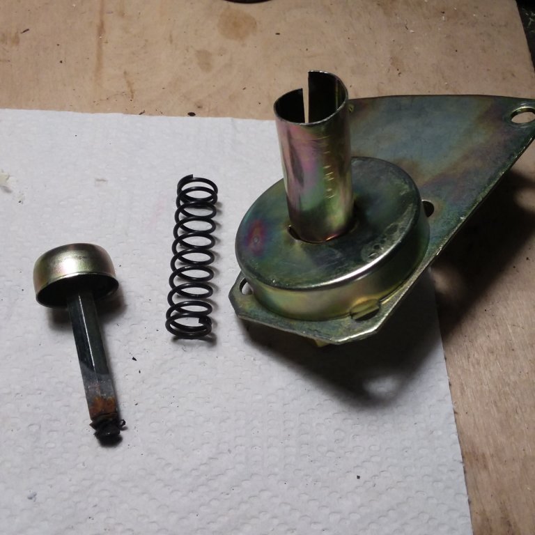

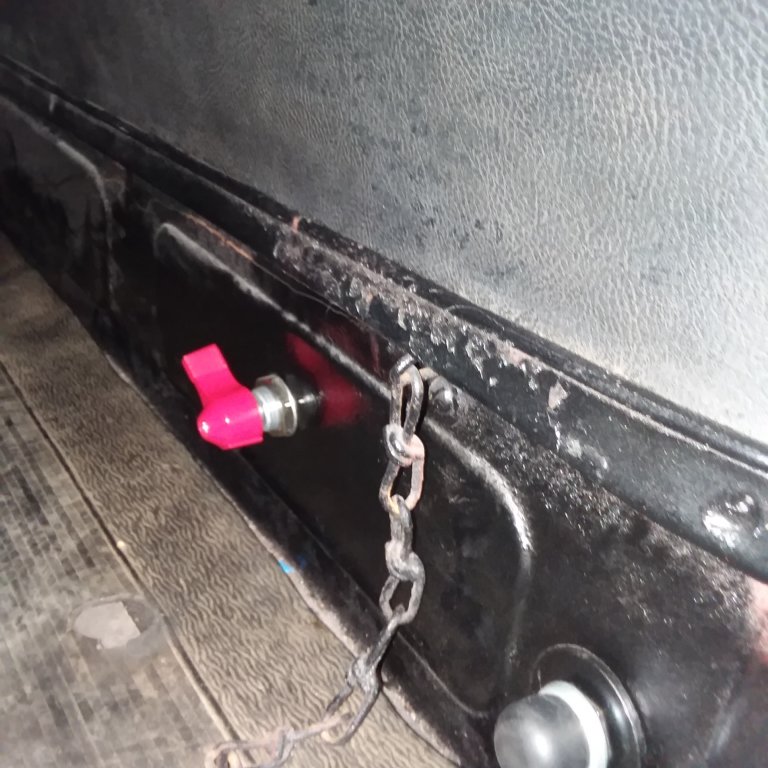

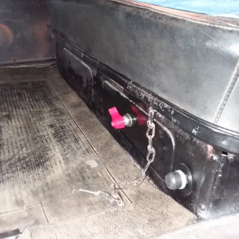

I had a similar style switch FAIL in my '26 (see above). It bent and welded itself on with the motor running. Thank goodness I had a battery disconnect switch within reach.
I've since done away with the cheapo foot switch and gone to a push button going thru a 6v solenoid from a late '40s ford pickup.
BE careful which foot switch you pick!

That IS NOT the same switch you posted your photo of - yours is the CHEAP IMPORTED junk one !!!

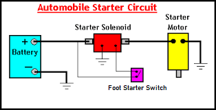

Adding a solenoid to the starter circuit will preserve your starter switch because less amperage will pass through the contacts - basically it would operate as a push button but look authentic. The diagram below would allow it to be used on 6v or 12v
starter 2.png (9.7 KiB) Viewed 3019 times

Professor Fate
Posts: 773
Joined: Tue Jan 08, 2019 12:39 am
Last Name: S
* REQUIRED* Type and Year of Model Ts owned: '23 and '26
Location: Taxachusetts
Re: Starter Button
Post by Professor Fate » Thu Sep 01, 2022 9:44 pm
tdump wrote:
Thu Sep 01, 2022 9:35 pm
Put me in with the crowd that uses a solenoid to save the original switch. a solenoid for a 66 f100 ford pickup will fit the top 2 bolts holding the steering column to the dash,a couple extra wires and use the original switch to make the solenoid work.
The switch I used was a 20Amp and it has a 25 amp fuse inline too. Just in case....
Red cutoff switch on left. Starter button on right in pic.
