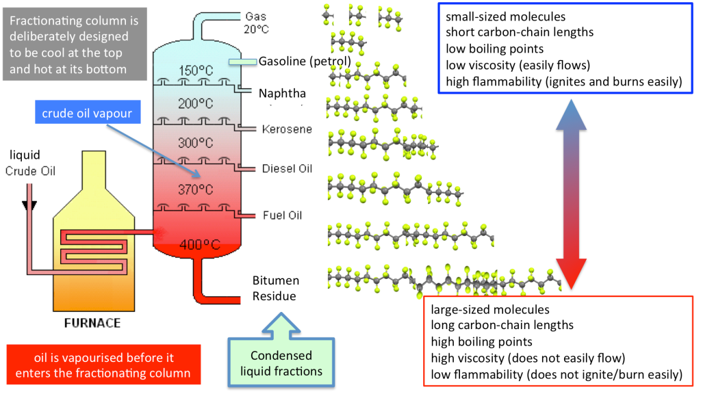

Agreed, I'm sure that the boundry was explored without mechanical changes like the carburetor for what fuels could be used, example, one of my T's still had it's dealership sales invoice with it and had on it that the T was filled with 8 gals of Benzine. Benzine, not to be confused with Benzene comes in on the distillation scale in between Naphtha and Kerosene.

We typically refer to the distillate that come off the petroleum fractionating
tower between Naphtha and Kerosene.......gasoline.
Yes, you are right in both instances.

Frank.
It looks like you edited your post to include an image of a distillation tower
to demonstrate that Gasoline is cut above Naphtha in the tower.
I am sure you also saw the other images which shows Naphtha (3 carbon atoms),
Gasoline (4 to 12 carbon atoms) and Kerosene (10 to 16 carbon atoms) being extracted in that order.
In most refineries today Naphtha is actually reformed into higher value Gasoline so the actual order becomes
confusing.
