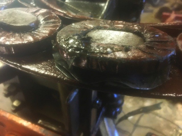

Next I pried the coil gently from the field casting so it lifted about a millimeter or two. Suddenly that coil was good again and in fact the whole mag came to life! The dead mag was a short on that one coil!. So what follows is the corrective procedure I have used:

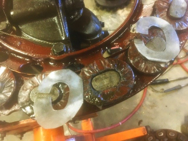

I pulled a gallon milk jug out of the trash and using scissors I made two washers as shown.

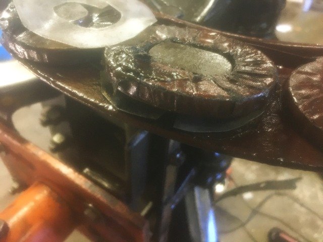

The first washer is inserted between the coil and the casting.
The second washer is placed with the slit on the opposite side from where the slit on the first washer is located.
The mag is again tested with the battery charger. All 16 coils were now functioning so I proceeded pushing the coil back down to place with hand pressure. I again tested the mag with the charger and compass and found that the mag is now functioning as it should.

Terry, that's really good work. Tracking down a faulty coil in the whole stack takes some doing. Thanks for the instruction.
I would caution using plastic milk bottle material as insulation though. I think you need something which will take more heat than plastic. It could be installed the same way though.

Allan, I hope you are wrong. I gave that a cursory thought whilst doing this and decided that the constant bathing in warm oil should protect this. If it does melt I think it may remain in place with a bit of sag.
I’ll tell you what, if this fails I will dredge this post up and confess my folly! Meanwhile if anyone has a better material which is 1) thin, 2) heat resistant, 3) easily cut to shape, 4) is non-conductive, 5) has elasticity similar to a milk jug, and 6) remains in place please inform me of it.
If my repair fails I will try your superior insulating material or I will cut the bad coil out and solder another coil sourced from another bad mag.
Another option is to carefully remove the coils from one of the spare mags. And splice replacements into my current mag.
The final option is to unwind a complete mag and rewind it with fresh insulating tape.
I hope to remember to post back here in a year to report on the service life of this repair.
