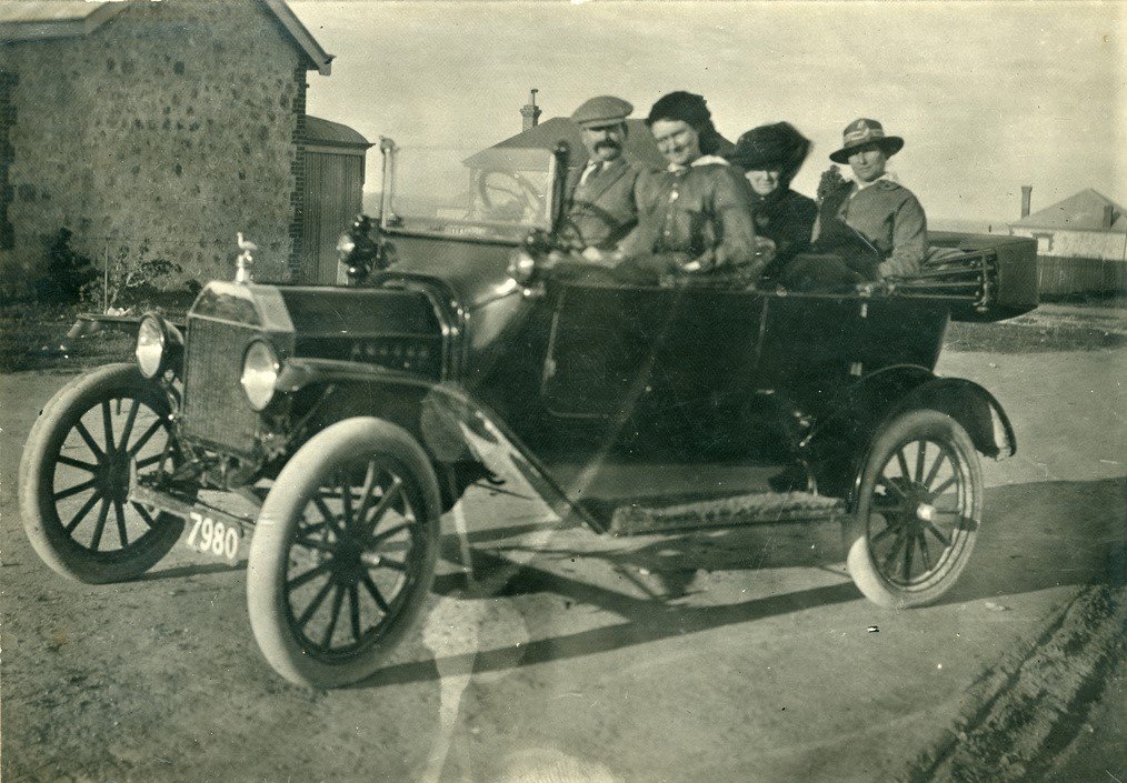

I'm working on a local history project where photographs of these Model Ts will be featured. Does anyone know what years these cars are from? I believe the first photo is of a Touring Car and the second is a Fordoor Sedan. The license plate on the car in photo #2 is from 1930. I'm not sure about the years these cars were constructed. I appreciate any information you might have. Thanks!
Vic

Touring is around a '17 - '22 - the Sedan is a '26 - '27. Without the engine #'s can't be more specific.

I'd say the touring has fixed bottom windshield glass and sloping frame. 1923/25. on a second look it also has a LH door so Canadian, which could make it a year earlier than a USA sloping windshield model. But still has a 2 man top.

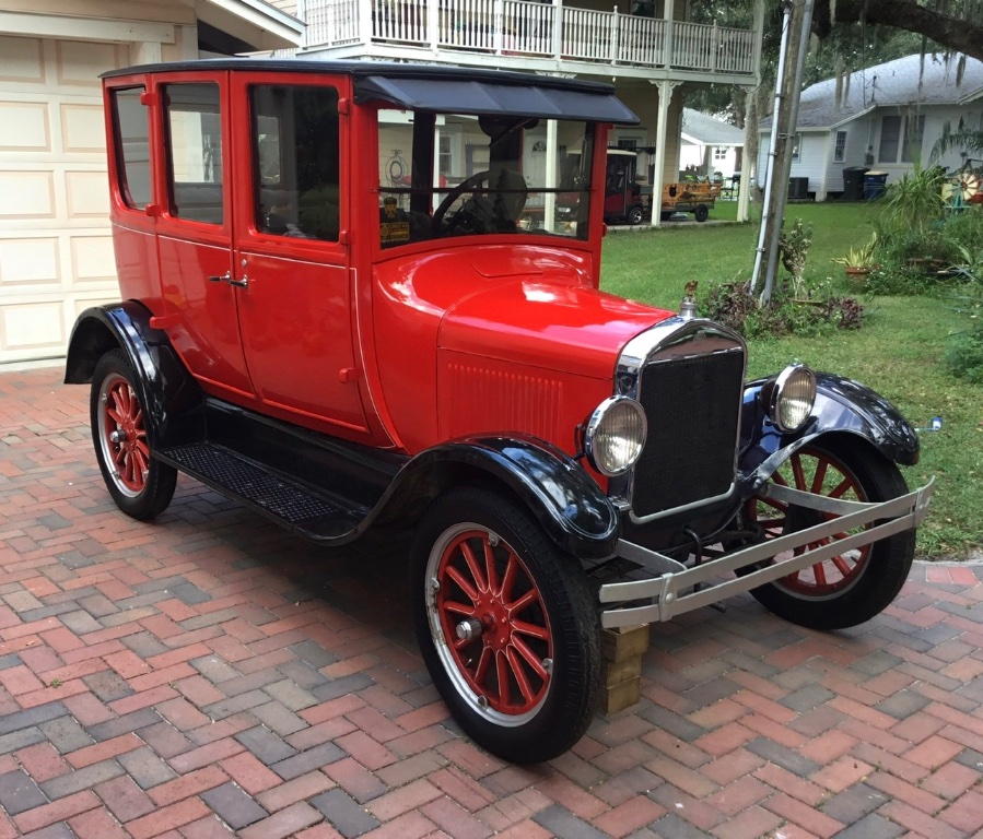

Due to the wire wheels the Fordor is most likely a 1927. My February, 1926 Fordor had wooden spokes. Jim Patrick

The Touring w.s. might be an accessory (or could be Canadian) - notice the side lamp brackets are present sans the lamps so it might be a non-starter car and the w.s. "screws" into the frame unlike a '24 - '25. Also appears to be a 5 pc. rear section.

Both cars were from Canada (Alberta).

In the 2nd picture the Ford 4 door could be 1926 or 1927 but with the head lights mounted on the tie bar and the wire wheels I would say it is a 1927. In the 1st picture the Ford touring is a Canadian made car because it has a drivers door. The touring also has a 5 panel back section last used in USA cars in 1920 and a sloping windshield not used in USA cars until 1923, but used in Canadian made cars after about 1919. The Canadian touring was most likely made just after the end of WW 1 and is a late 1919 or a 1920 car.

Also note on the touring the repair to the torn top requiring the top bow to be relocated slightly rearward. The car also has the horn button mounted on the top side of steering column like the 1916 - 1917 USA made Ford cars.

I think we can get it a little closer to a year, Canadian parts book list both the sloping windshield and one man top starting in 1920, well before the USA model, so to have the new windshield but using the run out of a 2 man top (1919) I'm sure it would make it an early 1920 model.

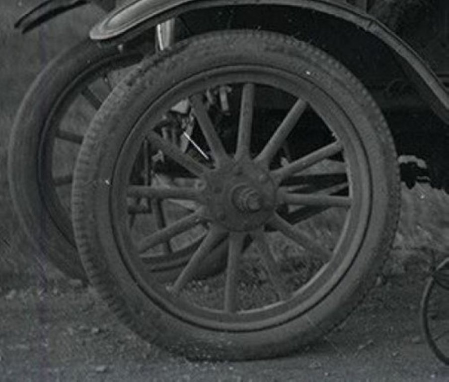

The tourer appears to have non demountable, round wooden felloe wheels. I would expect those to be on an earlier car than 1919. The slanted windscreen may be misleading. If the first bow was vertical, as it should be, the front bow would be a long way forward of the windscreen. If the windscreen was vertical, it would line up far better with the front bow. Perhaps the windscreen has been replaced.

Appears to be a replacement Honey Comb Radiator Core on the 27?
Also, the Tyre thread pattern is similar to what Blockley are making now with their new mould.

The Fordor is a late-production '27. It has the gently curved front axle like number 15,000,000.

I can rule out any date past 1920, it has an upper front radius rod with a lower kit on it, and I can rule out any date pre 1920, those hood bow clamps, unique to Canadian T's starting in 1920.

Just a reminder that it's a Canadian Ford as indicated by the original poster and others and the photo itself:
- driver's side door
- Canadian top saddle clamps (not saddles with leather pads and straps)
- side-curtain hooks on the windshield
- additional details I may have missed
Subsequently, you can't use U.S. model year changes to describe a Canadian car.
For the casual observer who thinks it is a U.S. car, it can only be a 1917 Ford. However, that goes out the window the details mentioned above.
PS: that horn button is correct for a U.S. made 1917 Ford. The combination light switch-horn button came out early in the 1918 model year and mounts 90 degrees from the steering column, not an "oversize doorbell button" on top of the column as shown in the photo.

I looked at the first photo on photoshop. A little higher resolution would help but it's not bad.
I'm wondering if the top was damaged by running into a low garage opening or the like? Maybe the windshield frame is bent, I can't be sure. Here is what I did notice.
1) It appears the top was designed for a straight (not angled) windshield as there is way too much overhang.
2) The windshield brackets do have cups for attaching sidelights. The two bolts holding the bracket to the body are not level to the body, maybe bent back? Perhaps whatever happened to the top and windshield damaged the lamps and he chose to remove them.
3) Most of the sockets are oval which in the US would have ended with 1917 production. The left rear upright appears to be square tube which began in 1918. Again, possible indication of damage and replacement.
4) Demountable wheels became optional in the US and Canada in 1919. Prior to that, in Canada all four wheels were 30x3.5 inch wood spoked.
5) The horn button is like the magneto horn in my 1917.
My guess - a 1917 non-starter car that had some top damage and repairs which may have required windshield frame replacement or resulted in a bent windshield frame. Great picture BTW. :D

Perhaps an early, wet, heavy snow collapsed the top and pulled the windshield back, or a slab of snow slid off a roof and collapsed the top.

Or, it's simply what parts books list, a sloping style windshield with lamp pads, 1920 to 23.

EDIT after some research...Kerry thank you for introducing me to "slanting windshields" on Canadian cars...that is a new one on me!
During this little adventure into researching the manufacturing differences between USA and Canadian built cars, it seems that in 1920, not only were there slanting windshields, but the tops were 1 man tops, too boot (which I now realized, you posted earlier)...if that is so, then this vehicle with a two man top still dates to likely a very early 1920 model (first year of Canadian slant windshield) and the carry-over of the 1919 top (which the book says was not supposed to be there, but is!)...pretty darn interesting
Thank you for making the distinction of the windshield...in 40 years of fooling with these things, I never knew that.

Here is a the first photo with twice the resolution. This might make it easier to look at in PS.

When were round felloe wheels superseded by square felloe wheels?

Allan, can't help on a date from round to square, parts books only say non- demountable tapered rear hub 1912 until 1920, or less hub 1909 to 20 and demountable start in 1919. As for the photo, I zoomed in at 500% and 99% sure they are square felloes.
My '27 is is in the 14,800,000 range and does not have the curved axle, so you are probably correct.

Ref: The touring car. Higher resolution helps. I've been referring to the Canadian Supplement to the MTFCI Judging guidelines which are pretty specific.
1.) In 1920 the Canadian touring cars had slanted windshields but they were not of the type on this car. Both sections could pivot and were secured by nickel plated wing nuts. This windshield is the same as the upright ones - only the top section could pivot. I think Scott is right that the windshield is bent or an earlier windshield is installed in later brackets if such a thing is possible.
2.) I notice a couple of pieces of baling wire that have been added to reinforce the top. One appears to attach the first upright bow on the left to the windshield. Something obviously happened. The patch on the roof suggest the bow was bent and ripped the top.
3.) The left front strap to the top appears to be hooked under the windshield pivot point - missing the top buckle loop. Also, look at the different angles of the two front straps
4.) Again, I see mostly oval sockets (1917) with one square one (1918+)
5.) It appears to have a wood steering wheel - Towards the end of the 1920 Model year they switched to a 16 inch Fordite wheel. Also, starting in 1919 the horn button was integrated into the steering wheel nut. This horn button is typical of magneto horns and would only be found in a 1917-18 car.
6.) Canadian wheels during this period were oval spokes and round felloes. These appear to be round spokes and square felloes. No explanation for the discrepancy.
I still think it's a 1917 or if a 1918, it has a mostly '17 top. It has definitely had some work done.

My guess for the touring is 1917-18. I think the we are seeing the original windshield bent back at an angle. Look at the cowl light mounts that are angled up and also the excessive distance from the front of the top to the top of the windshield. Obviously with the driver's door, it's a Canadian car, non-electric with (non-demountable wheels and oil side lights) and a magneto horn and standard horn button. I don't know enough about wheel details to comment although using leftovers was common for Ford of Canada too. The sedan is most likely a 1927 .....wire wheels, headlight bar, and nickel rad shell and headlight doors, all rare even in 1927 in Canada.

The touring has an over the axle wishbone. 1917-18
