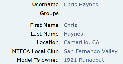

As you can see profile says I have a 1921 Runabout.
