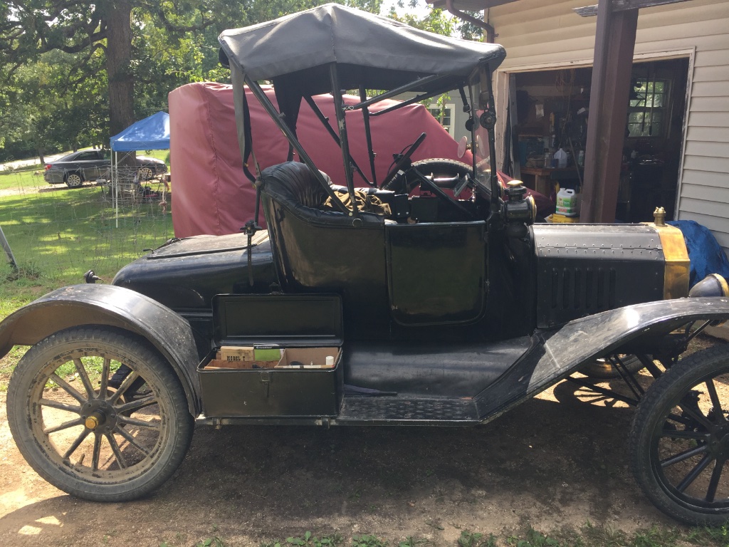

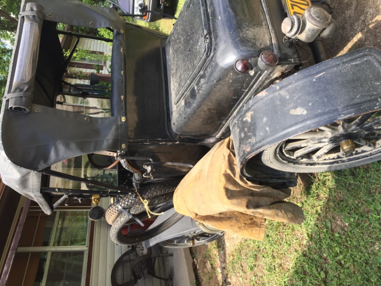

Got a call around 11 this morning (He forget to turn his phone on). Said his NH wouldn’t idle down and we’ll look see when he got here. 45 mins he got here as I was on the phone Martyn Vowell. I chatted and Steve chatted, then my sis came out with fresh ice tea. Twenty minutes later we were yanking the carb off for inspection. Inspection found a burr on the edge of the throttle plate. Smoothed it off and one other spot that looked tight, problem solved and idled well and normal.
After some more chatting it was time to hit the road,he had a dinner date with old friend Garret up in JeffCity and overnight camping. Sis went nanny on him for being out of water so he was sent off with a jug of ice tea. Everybody’s happy.
Click on pics and righ themselves. 🤷‍♂️🤷‍♂️

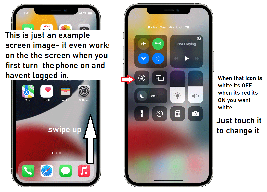

I believe this is caused by the orientation of the phone when the picture was taken. And may be smart phone model dependent.
I don't have the problem with my iphone 7 with the Portrait Orientation Lock OFF
To Rotate the screen on an iPhone or iPod touch with a Home button
Swipe up from the bottom edge of your screen to open Contol Center.
Tap the Portrait Orientation Lock button to make sure that it's off.
Turn your iPhone or iPod touch sideways.
