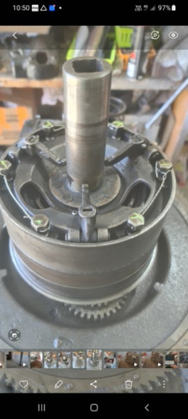

I have just reassembled the engine and gearbox about 5 months ago. I have just installed the engine into the car and tried hand cranking to make sure everything is free. If I put the handbreak on I cannot crank it. If I put it in the middle and jack the wheels off the floor I can crank it but the wheels turn. Have I put something together incorrectly or does it need to be run and go through the gears to free everything up? If I pull the handbreak on the forks are free in the box.
Here is a video.
https://youtube.com/shorts/dg7Mt1BbWFA?feature=share
Here is a video.

Before you start making adjustments -
When installing the hogshead, you have to make sure that the clutch fork (clutch yoke) is seated properly in the clutch shift.
The clutch shift is on the driving plate shaft, fore of the clutch spring and clutch spring support and pin.
The clutch shift has two grooves. You need to make sure the clutch fork is seated in the rear groove.
When the clutch pedal is pushed, the clutch fork pushes the clutch shift rearward which, in turn, pushes the clutch spring rearward.
Once you have determined that the clutch fork is sitting correctly in the clutch shift, then make adjustments to the clutch linkeage to get your "free neutral."

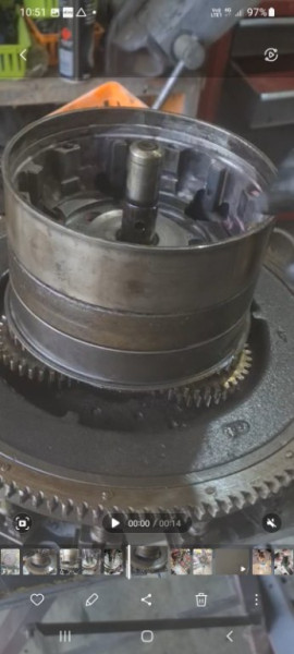

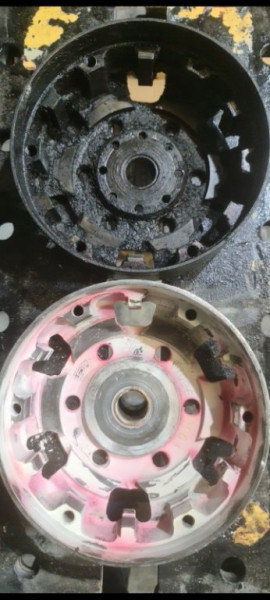

Here is the old and new drive plate. I hope I don't have to pull the engine back out. It's been out for 12 years.

Those are brake drums.

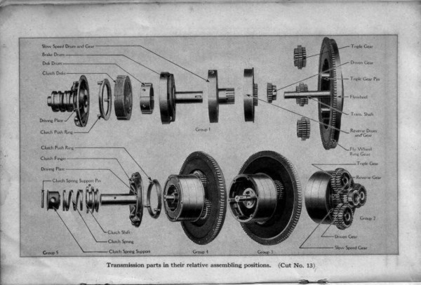

Refer to the diagram I posted. Click on it to enlarge.

Did you put the 6 clutch shoes back on?(not on lower drum pix)Myxr6turbo wrote: ↑Sun Aug 21, 2022 5:07 pmHere is the old and new drive plate. I hope I don't have to pull the engine back out. It's been out for 12 years.
I did recently work on a transmission with serious clutch sticking problems. The brake/clutch drum was replaced with a nos narrow drum that took the shoes. The shoes were left out. The clutch disks locked under the shoe securing notches. A remote possibility in your case also.
If the clutch disks are binding, put her in neutral & push the car back & forward to possibly free the disks up if only temporarily.
You put the transmission back together using the manual? Dumb question? There are those that have tried not using the book.

Did you lube the clutch disks when assembling? What did you use? motor oil? grease? Stuff like white lithium is like glue over time. Just a thought. It appears your clutch is locked up. If this is the case, running the motor with the wheels up & getting it hot may wash out the sticky stuff locking the disks. After a while running, try neutral, low & reverse to break the disks free.

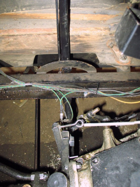

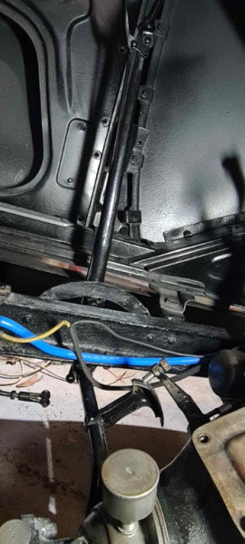

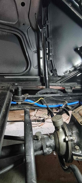

Linkage issue. See the manual. When the e brake lever is vertical, the cam should have pulled the clutch to neutral, disengaged. It does not. You are still in hi gear, no neutral. 10 degrees or so past vertical the cam engages & you have a neutral clutch. Very last of the video.
- Posts: 1958
- First Name: Robert
- Last Name: Jablonski
- Location: New Jersey
Re: Wheels turn when cranking.

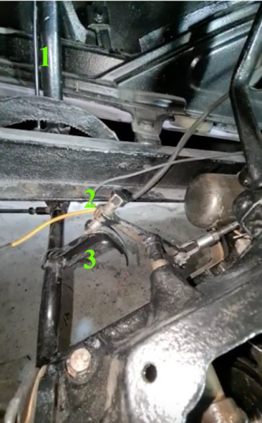

Tighten that bolt a few turns, three or four, so the bolt will touch the cam before the emergency brake lever is vertical. This is only an estimate on the amount of turns on that bolt since physically being there with you may result in one turn or less. You should have a nut on that bolt to tighten your adjustment, without, the bolt will loosen and present you again with your problem.
- Posts: 7342
What John said.
With the brake lever (1) straight up or farther back, the speed lever (3) should be raising the clutch lever (2) for neutral. With the clutch lever down you are in high gear.
I doubt that adjusting the screw will fix this. I appears to me that the angle between your brake lever and your speed lever is about double what it should be.
Looking past the brake light switch here you can see that with the brake lever straight up the speed lever has raised the clutch lever for neutral. Comparing the two pictures, I may have been mistaken about the angle of your speed lever (cam). They appear very similar. Maybe a screw adjustment is all you need.

In Steve's picture, he has the bolt inserted the opposite way, which is threaded in from the bottom, it's just the same as my car. The head of the bolt has more mass to contact cam section, and in turn to take drivetrain out of direct drive. Locknut is threaded from the top and then secured to hold adjustment.

Looking at a 1915 and a 1923, with the brake handle vertical the speed lever leans forward at an angle of 35º on both cars. Before you start changing anything, check your angle and see if it needs to be changed. I don't know if it's the same for all years, but on my cars the speed lever is pinned, not welded to the shaft. If your angle is wrong, and especially if the lever is welded, it's probably a home made bungle. Or, as Scott suggests, maybe the brake handle is pinned at the wrong angle. The dip in the controller shaft (under the drive shaft) should be exactly vertical when the brake lever is vertical.

Really quick update. After 40 years the model t started and ran. It was running rough as one of the coils is average and one of my new spark plug terminal has broken away and the entire rod comes out or the plug so replaced it with an old plug
After running it and pressing every peddle possible the disks are still stuck.
I'll pull ithe engine out this weekend.
Question: do i need to remove the pan to remove the gearbox assembly? Last time i had everything on the engine stand.
While the engine is out ill check and fix the brake handle.

Before removing the engine, check and fix the brake handle FIRST. If correcting the brake handle and double checking all external adjustments does not get the clutch working, the next step would be to remove the hogshead and look for any problems with the internal clutch adjustments and linkages.
- Posts: 7342
I don't know if they're available in Oz, but Autolite 3095 plugs are cheap and work as well as anything, at least in the short term. A set of new ones is an inexpensive experiment to see if your old plugs are a problem.
Yes, the engine has to be out of the car with the pan removed to dig into the transmission. But I'm with Pat. I would not pull the engine before fixing that speed lever/clutch lever mismatch. Have you measured the angle of your speed lever? Is it the correct 35º? Is the brake handle directly in line with the control shaft dip?
- Posts: 4955
You can disconnect the parking brake rods & pull back the lever more to get your clutch cam in a functional position.
Not sure if the question was answered on what lube was used during clutch assembly.
I would be getting the motor hot & alternating forward & reverse to free up the clutch. Compare the service manual to what you did if you didnt follow the book step by step.
Unless you know or suspect how you screwed up the assembly, work around the edges before pulling the motor.

Ok I'll keep trying to free it up. When I started it yesterday I removed the handbrake rods and then pulled the leaver all the way back so neutral was fully engaged but no brakes.
- Posts: 4955
Did you have a neutral? Low & reverse & brake pedals function? If so, your problem is limited to your hand brake/cam unit clocked wrong.Myxr6turbo wrote: ↑Wed Aug 31, 2022 5:56 pmOk I'll keep trying to free it up. When I started it yesterday I removed the handbrake rods and then pulled the leaver all the way back so neutral was fully engaged but no brakes.
If you have the 3 pedal functions, but still a sticking clutch, Lets hope running will free it up with a good, fresh oil bath.
If you still dont have a neutral, then that means big work.

it's still a little tight but the rear wheels are on the floor and I can now crank it by hand. Strange what ideas you come up with at 3am.
I ha e looked at the handle and it seems to me that the handle and the arms under the car are inline.
I have made a few adjusents. Does it look better?
- Posts: 7903
That looks better, but the cam that the adjustment bolt rides on is too far forward when the lever is straight up. It looks like the clutch is not being fully released when the lever is straight up.
Topic author - Posts: 89
- Joined: Sat Jul 17, 2021 2:40 am
- First Name: Shawn
- Last Name: Barnard
- * REQUIRED* Type and Year of Model Ts owned: 1926 coupe
- Location: Australia, Victoria
So the only way to fix that would be to pull the pin from the cam and move it and drill a new hole?
- Posts: 7903
That's what it looks like from here. On my '26-27 car, the cam lever appears to be about 20 degrees forward of vertical when the hand lever is straight up. The adjustment bolt contacts the cam face just a little past the sharply-curved part. Yours seems to be contacting the sharply-curved part. I don't think that is correct. I don't have a way to post a picture, or I would.
- First Name: Shawn
Ok, so the selector is in the correct spot for low/neutral? If so should the bolt be on the highest part of the cam?
- Posts: 7903
With the hand lever straight up, the bolt should be on the highest part of the cam, just past the sharply curved portion of the cam. On my car, that has the adjustment bolt pointing straight toward the "stem" of the mushroom-shaped cam.
- Posts: 7342
Your adjusting bolt (clutch lever screw) is turned in almost as far as it will go. That leaves no space for a locking nut and may be overkill. Back it off as far as you can without losing your neutral. That may change its angle to better coincide with the high part of the speed lever. It might also help if you widen the business end of the adjusting screw by turning it around with the head down. If it's a modern bolt, grind off the raised markings. A locking nut can go on top of the clutch lever (See my 8:44 AM 8-30-22 photo above).
