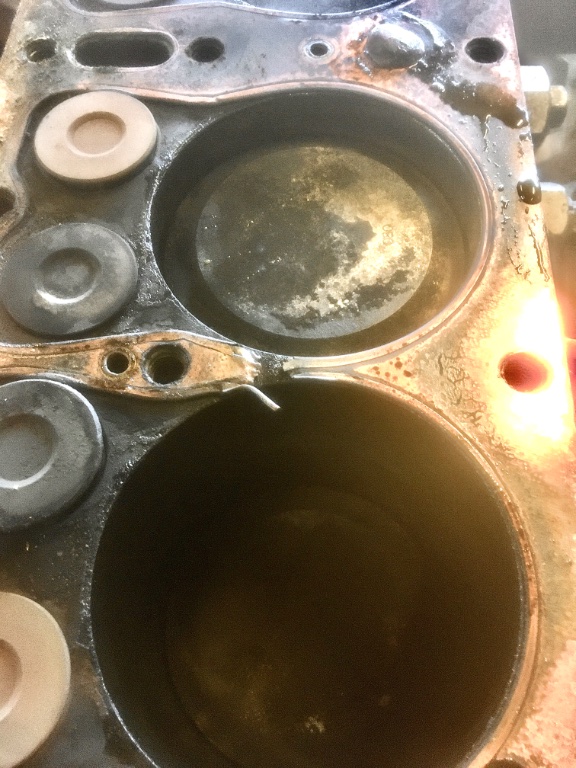

I had that happen to my 1927 last week. It was such a convincing knock that, combined with mag, starter and generator issues, I pulled the engine out.
I quickly found that the lack of power and sudden knocking turned out to be a blown head gasket. It is worth either a compression test or pull the head off first.
My gasket blew between #1 and #2. I found the deck was ok but the aluminum Z head is warped. .008” between 1 and 2, 2 and 3, 3 and 4. It is going to the machine shop tomorrow to get decked flat… again!
It’s easy to check for this problem before pulling the engine if there is no other problem.
The obvious thing I heard but didn’t understand was the “knock” was loudest near the muffler!
The knock was so convincing I checked all 4 rod bearings (all perfect) before finding the head gasket problem!
IMHO, TH

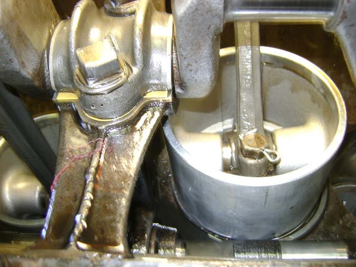

Replace a rod bearing without pulling the head? This is a trick I need to learn!

Yeah you cut the rod in half and weld it back together after rebabbitting it!!Dan Haynes wrote: ↑Wed Sep 07, 2022 12:32 pm"If the inspection plate is removed from the bottom of the pan, you will be able to see if a rod has run a bearing. The good news is these can be replaced in the car without even pulling the head."
- Posts: 6800
Re: Broken Crank?…spun bearing?
Or, you pull the piston down far enough to pull the wrist pin and drop the rod.

It is in fact possible to change a rod without pulling the head. Many years ago I lost a rod bearing on the tour associated with the Bakersfield swap meet. When we got it back I went shopping at the meet and found a serviceable rod. Dad told me how he and a friend did it years ago. Slide the piston down far enough to remove the wrist pin and the rod will come out. The car had a Rajo head and pulling it off wasn’t really an option that would work at the time. I had quite a crowd watching the job happening. It worked but not for the long term. Turns out I had a cracked low drum that was shredding the band lining and clogged the internal oil tube. The accessory oiling lines would supply enough to let me drive around on flat ground but as soon as I worked the engine hard on a grade they were insufficient and a rod would fail. That heavy 1926 Tudor would really walk the dog while it held together. In 2000 I bought it sight unseen off the classified page here on the MTFCA site. Dad and I got one way plane tickets and drove it home from Seattle to Sacramento in five days with zero issues. As soon as it got here it was nothing but trouble. They all have personalities.

I too have successfully changed a rod out the bottom by pulling the piston down. It was great fun! Era cast iron piston with a ring near the bottom, in cylinder number one. Changing the rod was easy. Getting the bottom ring compressed to go back up? Not so much.
HOWEVER!!!!!
Not all blocks are exactly alike!
I later tried to change a rod the same way, also number one. This time, there was just enough difference in the block casting that the piston wouldn't go quite far enough down. And the wrist pin could NOT push to the side enough to release the rod.
I fought that thing for an hour before I gave up and pulled the head. No twist or turn or push could move the pin quite enough. The worst part was the lower ring again had popped out, and fight it as I could, did NOT want to compress and go back up!

I have done two now. The first was in Henrietta, and I didn't want to disturb her crusty appearance any more than I had to. No 1 rod was replaced with a used equivalent, scraped and timesaver lapped. We did have moments getting the bottom ring up the bore, but doing all the work on a hoist made it all much easier to manage.
The second more recent one was on an engine on a stand in the workshop. The paucity of head gaskets made us do this number 4 rod without pulling the head. The bearing had been poorly tinned and had shed a few chunks from one side. This was discovered when fitting a starter flywheel to the unit. The bearings and crankshaft grind were recent, so I sent the rod away for remetalling, and had it back from interstate in 6 days, thanks to Frank.
This piston had replacement rings, the bottom one being grooved around the circumference. A twitch of copper wire compressed it nicely and up she went.
