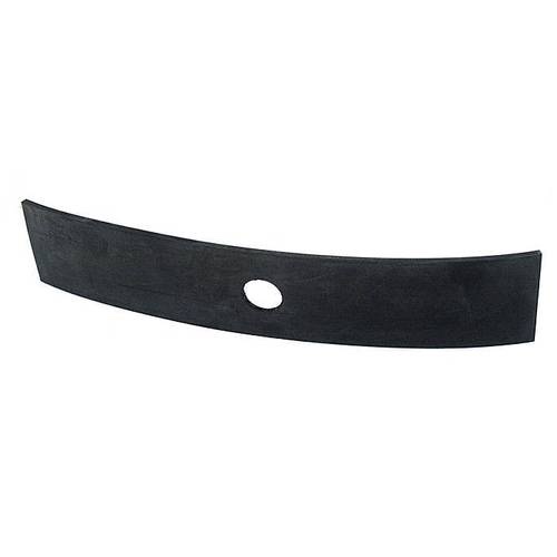

PS. If you go to one of the Model T part suppliers, (Snyder’s), you can get the proper treated square headed bolt that will be longer than usual to bring the leafs together after lubricating between the leafs with slip paint (graphite impregnated paint). I apply the slip paint after priming and painting both sides of each leaf, but some members advocate applying the slip paint to bare leafs. After tightening, you can then cut off the excess threaded portion about 1/16” from the nut with an angle grinder then Brad the end so the nut cannot back off. When installing square headed bolt, be sure to position the square head so it fits in the square hole of the rear crossmember. This ensures the spring is perfectly centered. Also, when positioning rear spring up in the rear crossmember, don’t forget to position the rubber spring cushioning pad on top of the spring. My photo shows the rubber pad for 1921-1927. The leather pad is for 1909 to 1920 Model T’s
