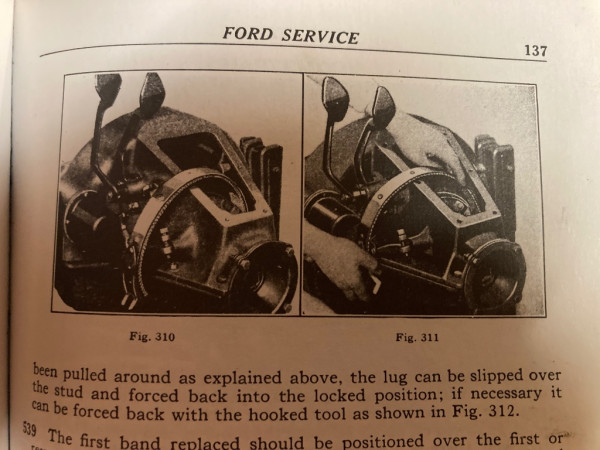

I’ve changed a few sets of bands by removing the hogs head. I want to try to do a set through the hole. I have detachable ears. I will try on my ‘24 or ‘22 and they do not have newer larger brake drum. The one car just needs brake band the other needs all 3. I’ve been told it’s too hard, it will distort the bands, I need to feed them in front of reverse and then pull them in place, feed them behind brake drum and then move forward, you can feed in cotton bands, but can’t do Kevlar. All maybe true, but looking for words of advise from someone that has done it a few times. The service manual said it should only take 40 min.

Have done many sets on cars didn't find it difficult at all ,used kevlar only thing I would suggest would be to get the strap tool that the venders sell makes it a lot easier to pull band around drum .good luck

"feed them behind brake drum and then move forward," That is how I do it. Re Kevlar, would be no different than cotton. It is the wood bands that really should be installed with HH off.

I always change the bands through the inspection opening. After much "advice" saying it was too difficult, I couldn't believe how easy it was. In fact, the most time consuming aspect of the job was actually relining the bands; not extracting or replacing them. Obviously, care must be taken not to bend the bands beyond the point of elasticity. I start and finish from the brake drum since the bending required is the least.
No need for the special hook tool - coathanger works well. This is all with Scandinavian linings; others could be more difficult.

Yes it can be a hassle. The time study in the Ford service manual uses the idea that everything is in its place, and it all goes 1 2 3. In reality it’s most of the time that it doesn’t. The information that’s in it is really good if all is well which a lot of the time it doesn’t go well. If you were doing it on a daily basis at a shop it would get to be easier as time went by. Most of us don’t do it all the time.
