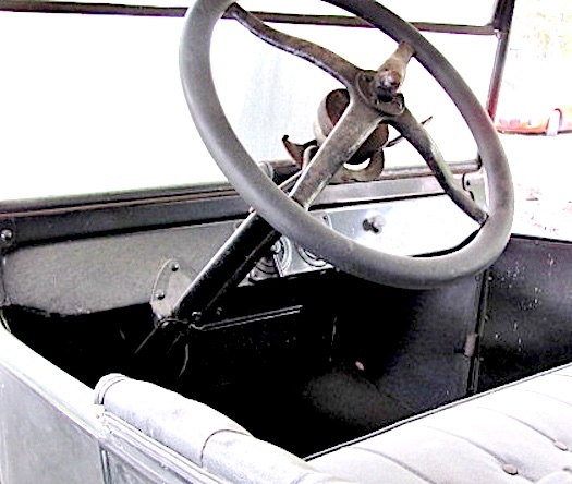

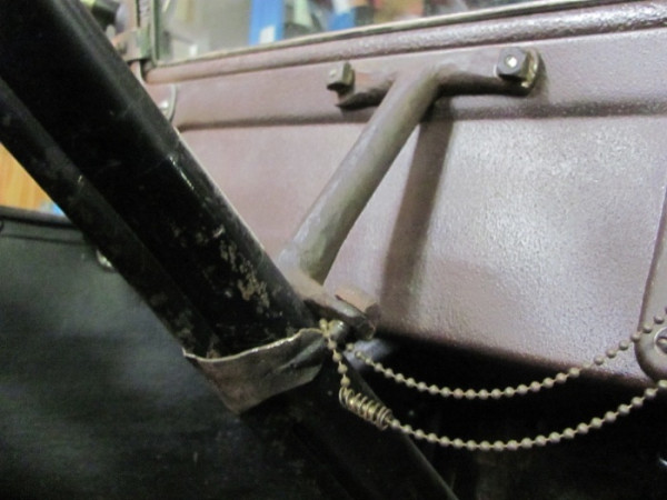

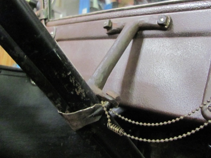

Suggestion by Craig is likely good and easy. That bracket is available used or repro. Ford riveted the dash panel bracket on the open cars, but bolted (single slot, round head machine screw) them on closed, Service Bulletin stated to bolt on if dash panel was in the open car, as riveting in place too difficult.
Or the accessory one's in Lang's catalog will fit. Just needs holes drill up high.
Here are some original accessories used prior to Ford making it's version.
Ford bracket used beginning early spring 1923.
IMG_1832 (640x480) (2).jpg (84.72 KiB) Viewed 2380 times
Nellie, my early '23 Cut-off, with steel firewall didn't have the bracket, as it was built before the new dash panel bracket. So found this 'home forged' bracket at Chickasha swap, the ole farmer heated up the forge, and split and bent this iron piece. The surround metal part is from a speedometer bracket he used! Crafty folks back then!

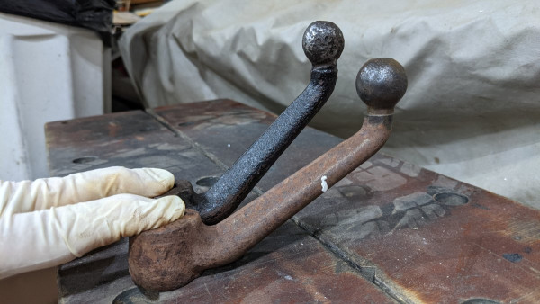

This shows the late pitman arm that was on my '26 Runabout (black with submicroscopic ball) and an earlier, rusty arm with a better ball. You can see the angle difference.

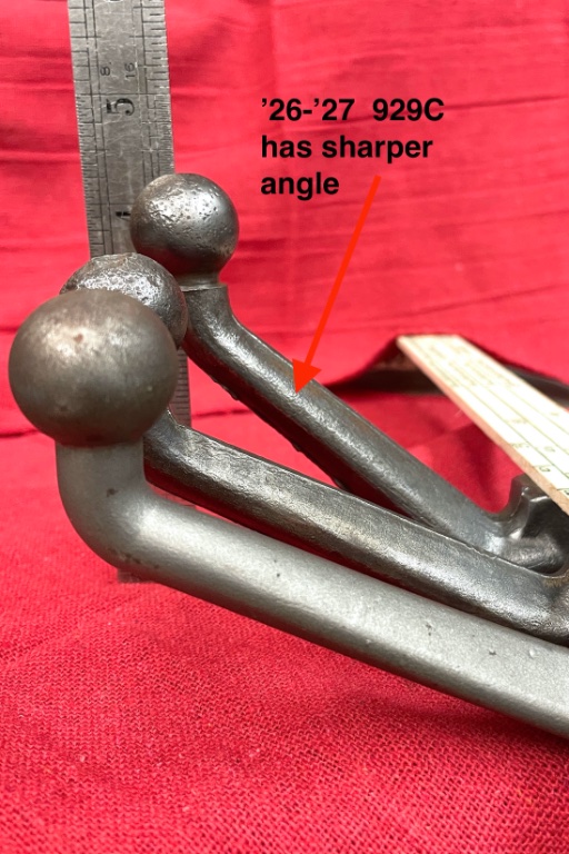

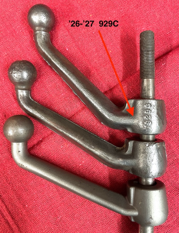

Here's another comparison of ball arms.
The '26-'27 has steeper angle, if you lay it upright, measure to top of ball, should be over 4". The earlier are shorter or shallow in angle.
The factory '26-'27 has casting numerals 929C, that is the Factory Number of the Ball Arm T-3547B
The earlier (about '13 - '25 Ball Arm is T-3547, Factory Number 929B. The reproductions are the 929B shape, repro shown in foreground.
