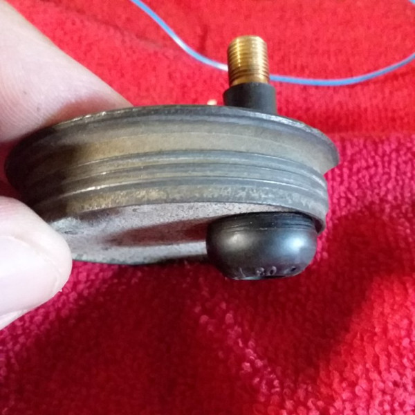

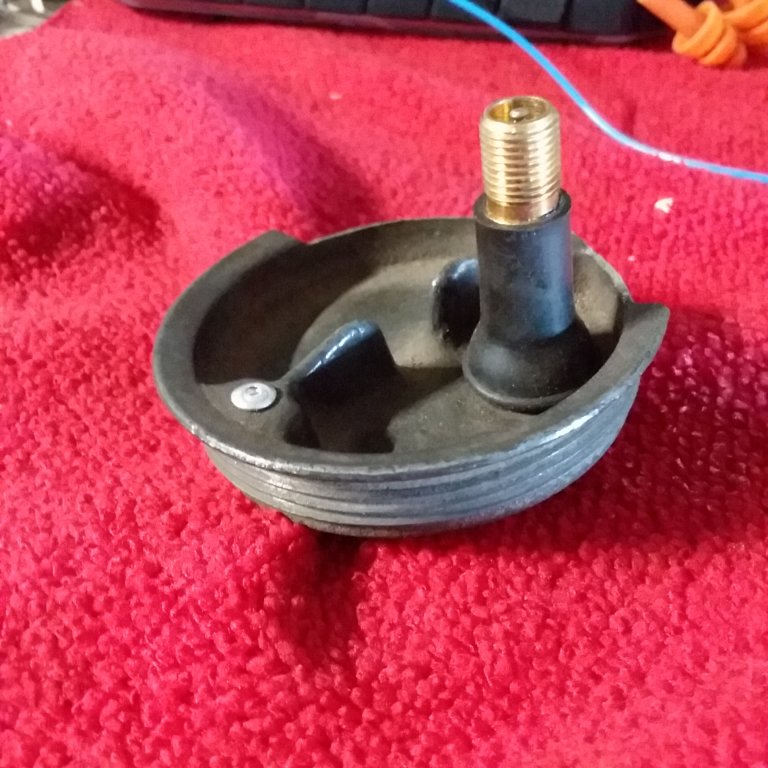

Post by Professor Fate » Sat Sep 10, 2022 5:06 pm
Make up one of these. Great way to check stuff out. Just a couple of psi will do it. Minimal just a pound or two to make the valve or cap hiss when you open them. Make sure you plug the vent hole on the cap. I used a pop rivet.
Don't over pressurize!
