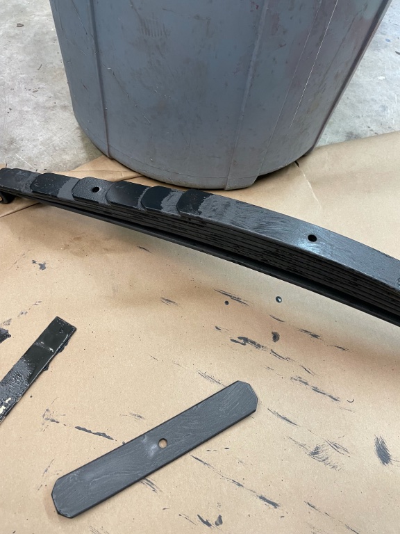

I have done it two ways. I have primed each leaf first with epoxy, painted them black, the painted the sides with graphite and assembled. I have also primed the leaves, painted with graphite, assembled THEN painted. There isn't much of a difference at the end of the day, but I prefer to assemble then topcoat. Always prime the leaf so rust and corrosion doesn't happen - I have done this on many cars and so have many others and it doesn't affect the way it rides. It also doesn't wear away after a while - the slip plate takes care of that.
Posts: 4083
Re: Decision Time...
Post by DanTreace » Tue Sep 13, 2022 10:21 am
Bill
Have at times just used the Slip Paint as primer when the leaves have been stripped with wire brush or disc sander.
On most, with rust pits still showing, that you really don't want to grind away (preserve the leaf metal as much as possible), have then primed the leaves. But my primer choice is Rustoleum Rust Reformer, (spray bomb) it locks in rust pits, dries fast, is durable black primer. Then over that I brush on the Slip Plate. Then dry, assemble the stack. Finally finish paint over the assembled stack with good black enamel.
