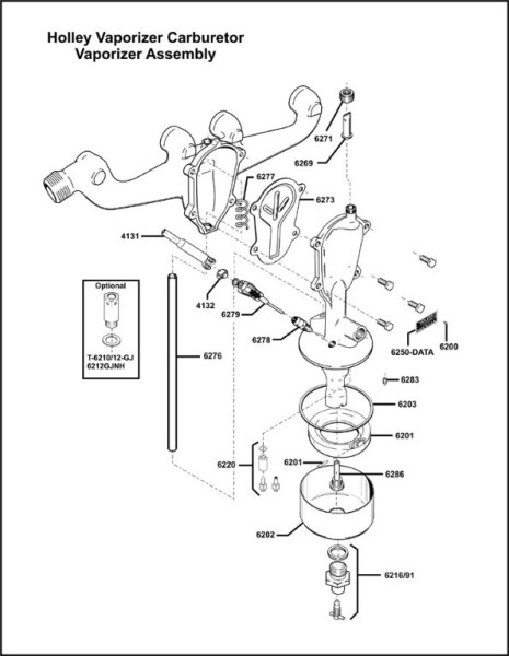

Re: Carb Rebuild
Here is a view of the vaporizor carb. Many suppliers have parts for these. I'm sure you can rebuild it. A common problem is the plate 6273 gets a crack in it. Many times the carb just needs taken apart, inspected,and cleaned.

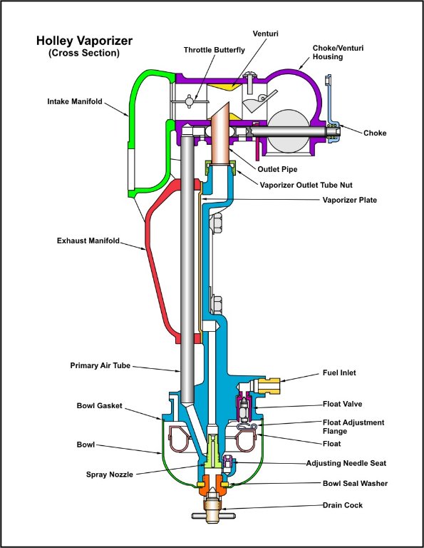

Re: Carb Rebuild
Edwin,
I went through one of these just a couple of years ago. Not that bad to rebuild but here are a couple of tips. The one I worked had been repaired and would not run at all, so the guy asked me to look at it.
Make sure the plate is sealed on both sides, I purchased a new plate as they are always pretty rough, and then filed the surface of the manifold and the top of the bowl to make sure the plate seals.
Next make sure that the air damper swings freely, it helps build vacuum to draw the fuel.
Make sure the vaporizer air tube nut, its the small brass knurled nut is tight and seals.
And finally the nut for the bowl, where the drain screws in, it is the same nut as the Holly NH carburetor, with one major difference. The carburetor nut has holes drilled in the sides, and the vaporizer nut does not. During the first repair a carburetor nut had been installed that allowed fuel into the passage at the bottom of the vaporizer unmetered. As a result it was getting way too much fuel, once I figured out was the problem was I was able to get the correct nut from Chaffins and the problem was solved.
Finally, when I got the vaporizer back on the engine, I found it does take a bit more choking than a carburetor does, but once it is started it was easily adjustable and ran just fine.
With the two diagrams provided, you shouldn't have a problem, if you choose to do it yourself.
Good Luck,
Kevin

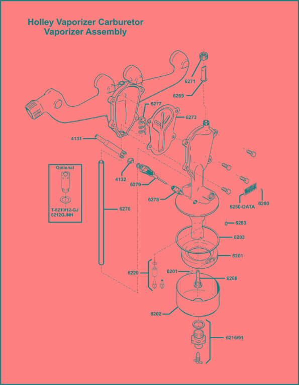

Re: Carb Rebuild
That's an excellent thread link Frank!
The 6273 vaporizer plate on mine had a big smile rusted out of it when I took it apart
. Kinda like the big smiley!
New plate, 6276 tube and 6277 heater coil. 6269 outlet pipe as I ruined the old one getting it out.
That little screw.
Some filing, sealant and got lucky on Lucky the TT. 3 crank-pulls (2 were choked) when cold and it was running.
On an engine with a quicky valve job that hadn't ran in 35 years. Dare to be different: Fix the Vaporizer. Not Vicks, the Vapo-Rub.
Send it to Russ Potter if you don't wish to do it yourself.
Come back and let us know if you would.
Mart's drawings and the original pics we have were a blessing in figuring that thing out.
