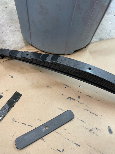

Sarikatime
- Posts: 713
- Joined: Sun Jan 06, 2019 12:47 pm
- Last Name: Seress
- * REQUIRED* Type and Year of Model Ts owned: 1912 Towncar, 1915 Touring
- Location: Prescott, Arizona
Re: Decision Time...
I have been told many years ago to use the paint in the picture. Rebuilt all four of my springs this spring and used this spray again.
