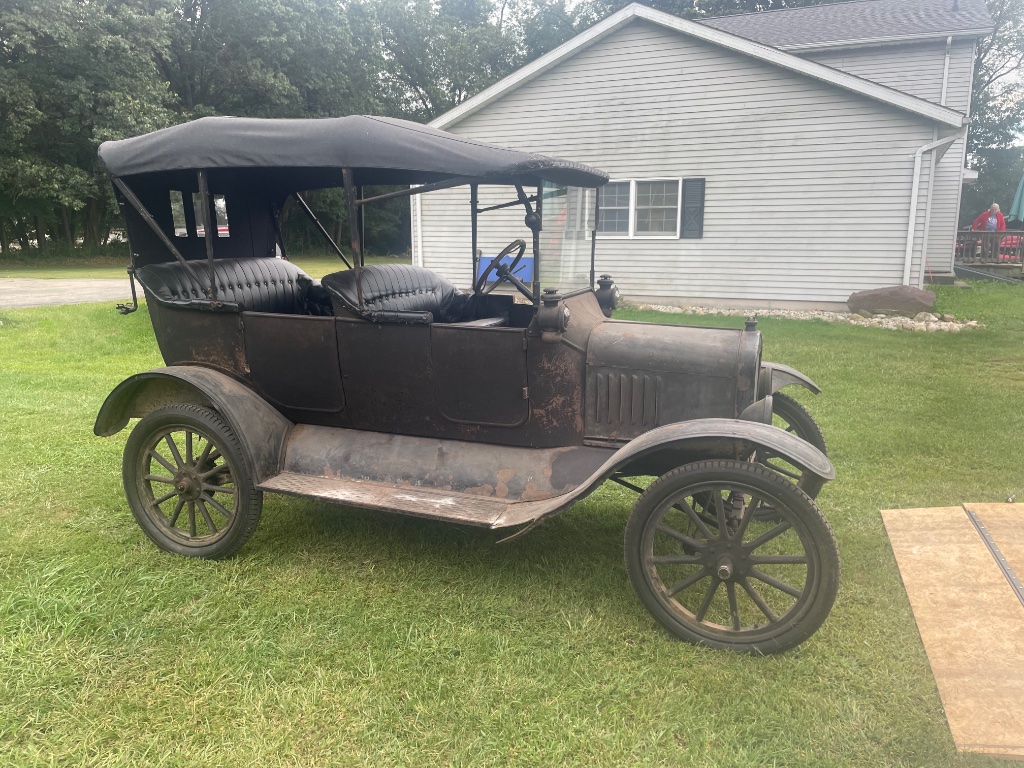

So my dad and I picked this up this weekend. An 18 touring in almost an original state. How should we preserve the finish on this car? We will keep it original. Suggestions would be greatly appreciated. I restore cars and this is a new one on me. Thanks Mark Eyre

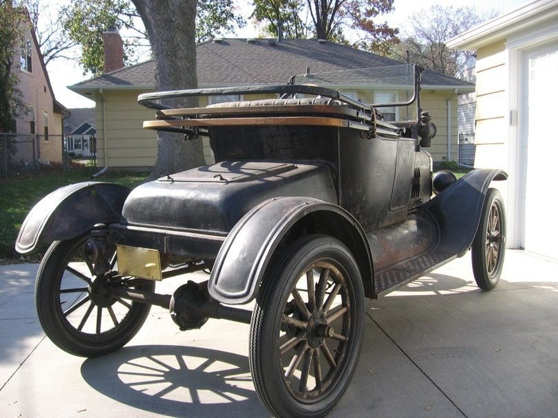

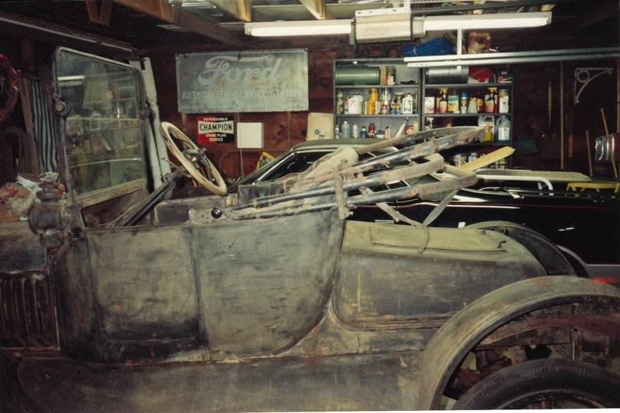

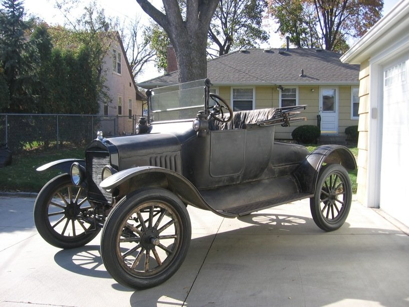

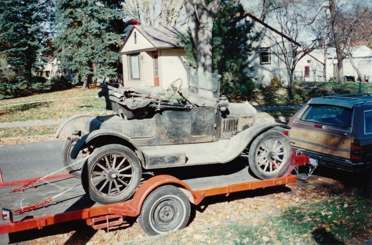

My advice is whatever you decide to put on the paint (if anything at all), clean it first.
After I bought my 1917 roadster, I stopped by an auto detailer on the way home and had the running gear and engine compartment steam cleaned to get rid of decades of country road dirt.
The original owner of my car had shellacked the body, fenders and splash aprons, etc. I have a photo of it from 1947 after second owner bought it from the original owner and the car was still very shiny. Unfortunately, the second owner poorly stored the car causing the shellac to become hazy.
After I brought the car home, I washed it with soap and water. I used mineral spirits to remove additional grease and grime from the engine and running gear, etc.
I used denatured alcohol to remove the shellac. This had an added benefit that it livened up the factirt paint. On the baked sheet metal, the denuatured alcohol doesn't hurt the paint at all. However, on the body, which does not have baked paint, the alcohol can completely dissolve the gilsonite paint if you let it sit in one spot for too long.
After the above, I went over the sheet metal with fine polishing compound by hand just to clean it further. Then I waxed it with automotive carnuba wax.
My car is far from the best example of an unrestored Model T but it turned out nice none-the-less.
See photos below - first two are before, second two are after.
Some folks like to coat everything with boiled linseed oil. To me that seems to make everything look wet.
Some folks wipe down their unrestored Model Ts with kerosene - an old used car lot trick. It doesn't hurt anything but does attract dust.
I did know a fellow who had a really nice unrestored 1919 touring with very good paint and he would wipe down the car with WD-40 instead of kerosene. Made it look real nice.

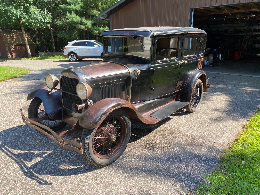

We powered washed a 1929 Model A Fordor and then sprayed it Rustoleum clear gloss. It came out nice and is holding up well.

Thanks everyone I have a good idea of the job ahead now. Washing it tomorrow is job 1.

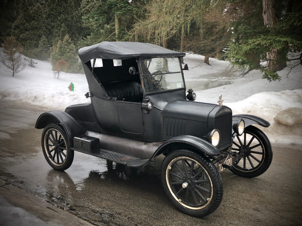

- Posts: 7133
Re: Preserve an original finish help needed
Henrietta is staying as she is. After 97 years she has weathered well. We did not even disturb the grease coating around the outside of front hubcaps when fitting new wheel bearings.
When asked if I intend to restore her, the answer is a firm, but polite, NO! Most people agree. I love the fact that after I have cleaned the windscreen,I am done with cleaning. But doing nothing takes some getting used to. When cleaning the windscreen, I very carefully skirt around the original 1955 waterslide decal which serves as a registration sticker on our cars. It is still on the plate glass windscreen. If ever I break the glass, I have a copy of the unused 1956 decal which came to me with her paperwork. The copy will go on the glass and the original kept on file.

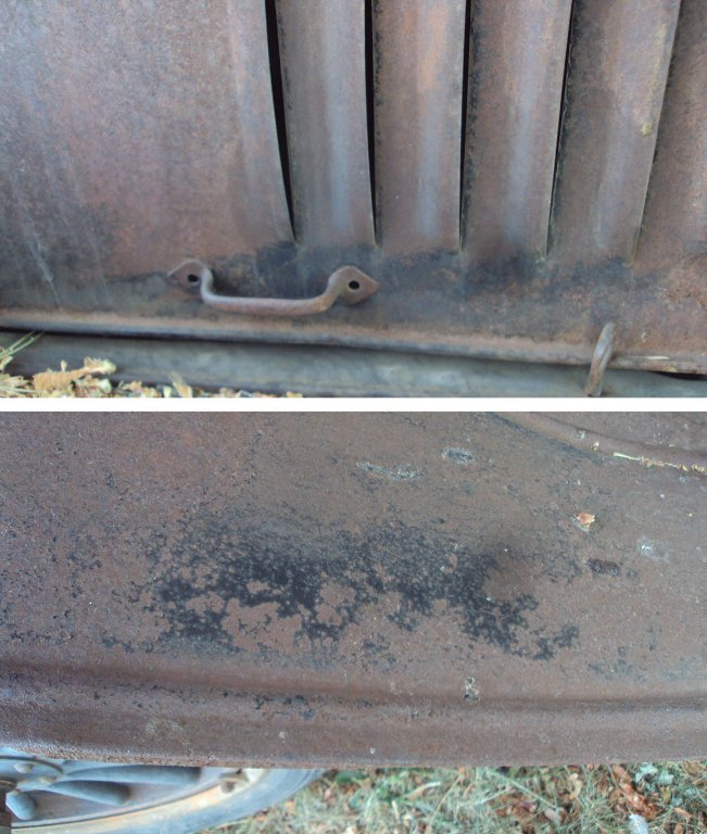

The car in the first picture has areas of active surface rust and what appears to be a spreading oil stain on the splash apron near the hood. I'd want to arrest that rust.

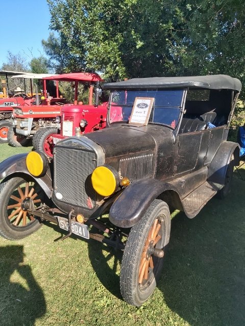

I give mine a rub over with a rag soaked in Penetrol maybe twice a year. It give a low sheen to the old paint.
