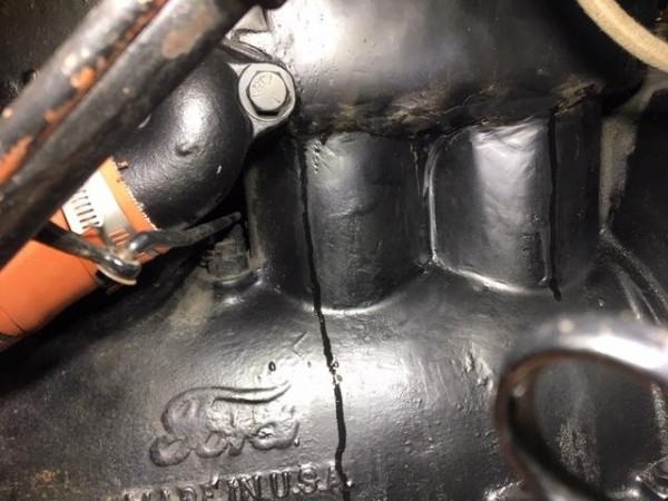

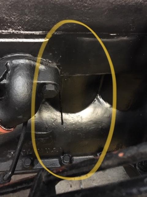

Just went out to check and I think I may have bigger problems- I'm leaking from the water jacket in two places.

Re: Leak from head gasket.
Cracked block, looks to have been repaired before, a repeat of your poo of choice might help.
- Posts: 5599
From the second photo - yep, you're S.O.L. ! One can see how "the crack remedy" was smoothed out - more than likely J.B. Weld.

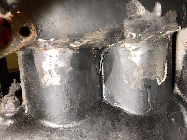

Ruxstel24
- Posts: 2419
- Last Name: Hanlon
- Location: NE Ohio
Much clearer picture.
Clean/sand it down and see what was used and either remove and start over or reapply.
The good news is it only has to hold water, no pressure. And you don't have to pull the head.
Or pull engine and have it welded or replace it.

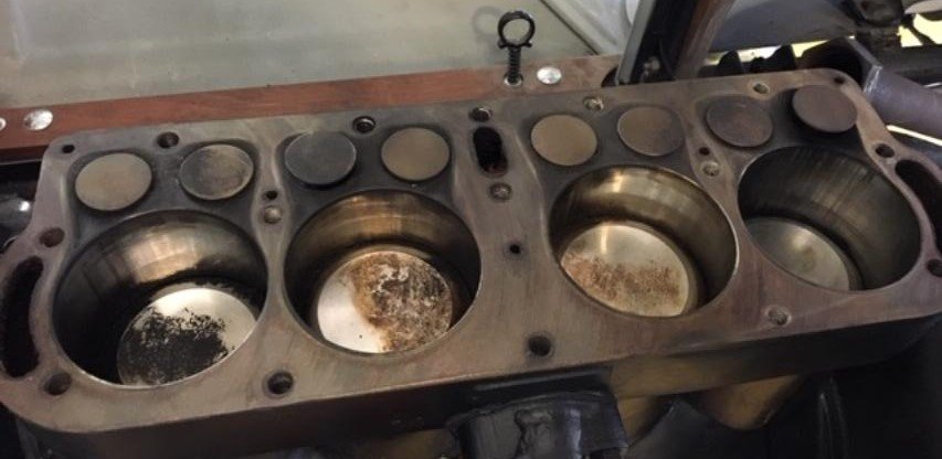

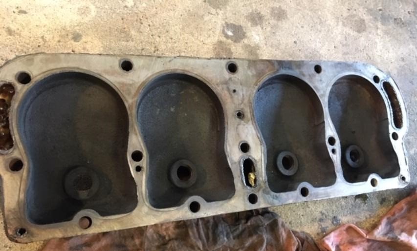

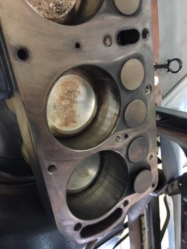

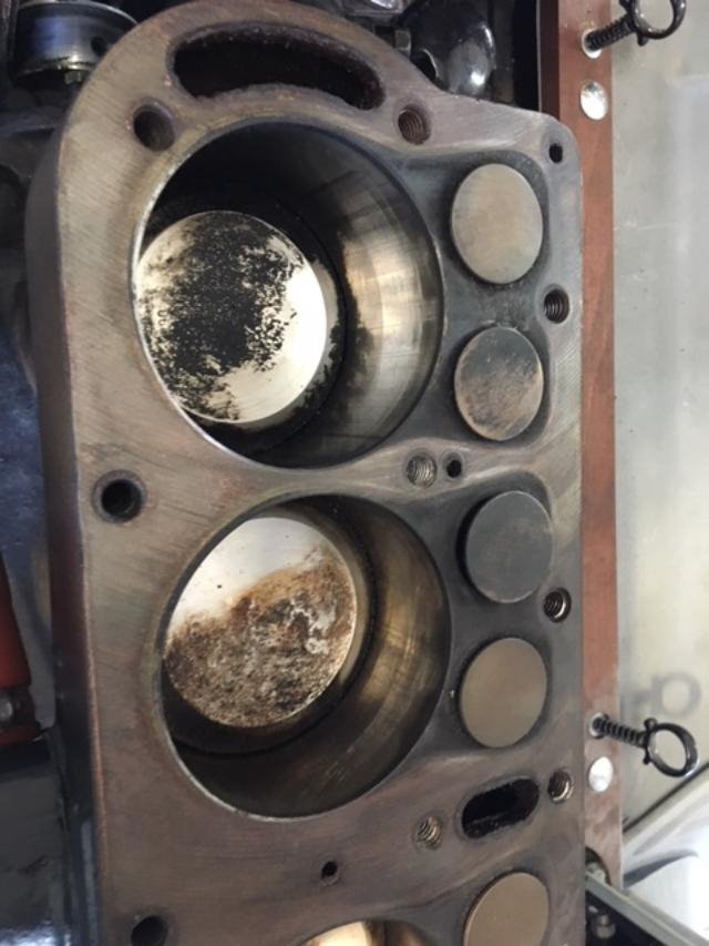

Here's the news as of today, the evidence shows that the motor has been recently rebuilt with new .060 pistons and valves, and is very clean, and the two weepy spots looks to have been repaired at some point and tiny holes have re-emerged. The head was clean and crack free and so is the deck.
Here are pics of what I have found:
No Problem fozz, Lots of blocks have these freeze cracks. It can easily be fixed and will last for many many years of driving with a simple easy fix.
Here's the way I have fixed my '12 block with the same leak. After it is cleaned off like you have done, I shaped some thin brass shim stock to fit over the cracks. I applied to the crack and glued the brass metal over the crack to give additional strength and also smoothed over the patch with some more ULTRA BLACK. Paint over the patch and forget it is there! The problem with a JB weld patch is that the block will contract and expand with the hot and cold cycles and the Ultra Black remains flexible and sticks Very good!
