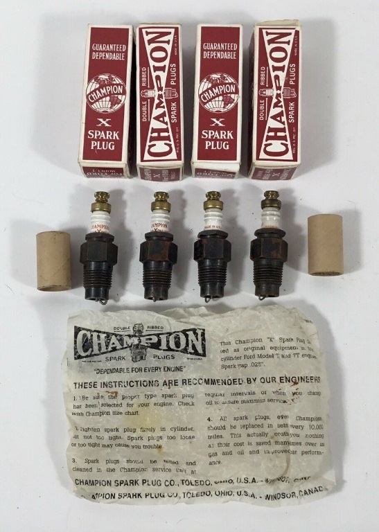

Edison #14 are used on the Model T. They are desirable because of the close friendship between Henry Ford and Edison who was one of the few men Henry idolized and held in higher esteem than himself. The gap is probably .025”, the same as on the Champions X plugs, but I’m not sure. Jim Patrick
