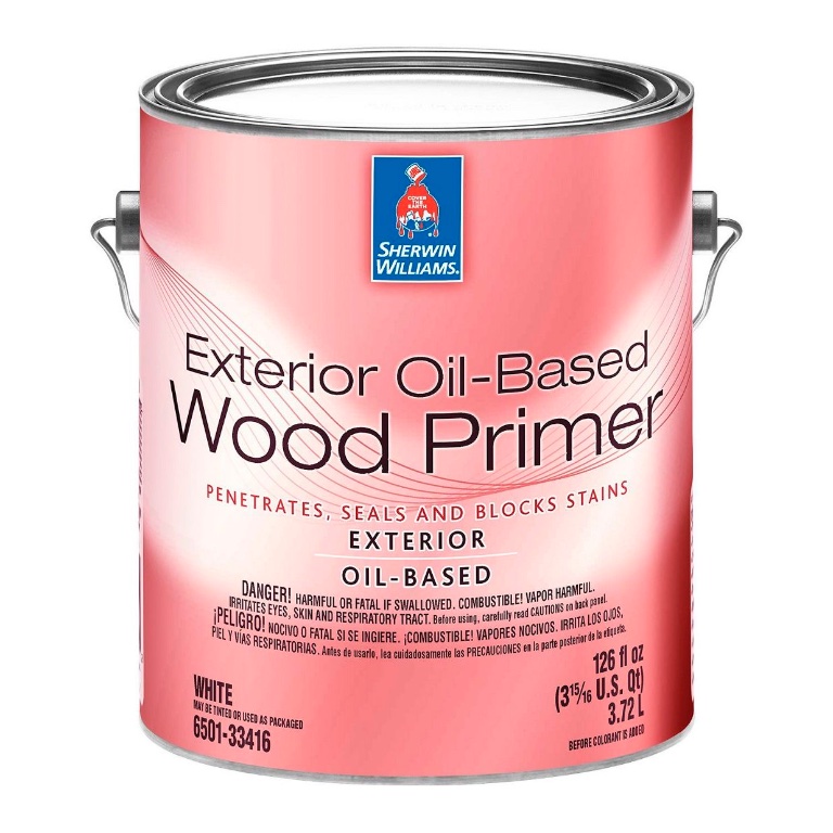

Sherwin Williams has a great old school gloss Black, brush applied enamel that levels out perfectly. Over new wood, it should be primed with their oil based alkyd primer. The primer is white, but Sherwin Williams can tint it black for you. I painted my spokes with it in 2010 and it still looks like it was just applied. Jim Patrick
