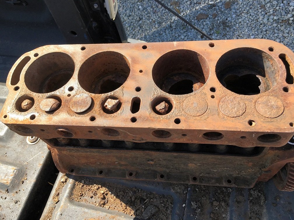

As Pat suggested patience and penetrating oil are essential. The photos below are from a 1927 block of mine that a previous owner apparently tried some heavy brute force to free the pistons and valve. All four pistons had their tops punched through and four of the valve heads were broken off. The connecting rods had even been torched in two, presumably as the easiest way to disconnect the crankshaft. As shown, I did eventually get the pistons and valves out.
I used a goodly sized metal bar as a punch rod to bang on the pistons from the underside, resting the rod on the piston pin area. If you can eventually get the piston to budge just a bit, you are home free. Just keep squirting penetrating oil around the piston as you bang it up and down to increase its range of movement. As for the valves, first remove the pin holding the spring seat so the valve isn’t held down by the spring. As Joe Bell said punch the valves up from the underside. For the valves having their heads above the surface of block use channel lock pliers to grab the heads and apply a twisting force. Again, if you can get the valve to move using a drift punch and/or the channel locks, then use the oil and go up and down, back the forth to wiggle the valve out.
