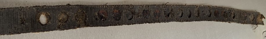

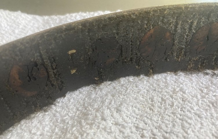

Yesterday I jumped into the project of replacing my transmission band with Kevlar bands. I assumed my bands were cloth, because it seems that cloth was the most popular band material. When I removed the rivets and looked at the old bands I was surprised to see a thin cloth band, with a leather band attached to the cloth band. Additionally the leather band had around 16 holes punched in it, with wooden plugs placed in each hole.
Was this a popular type band 'back in the day'? I would appreciate any information someone might have.

The "wooden plugs" are likely corks.

Yup. "In the day" several manufacturers supplied band lining with cork inserts. They were quite popular and got good reviews.
