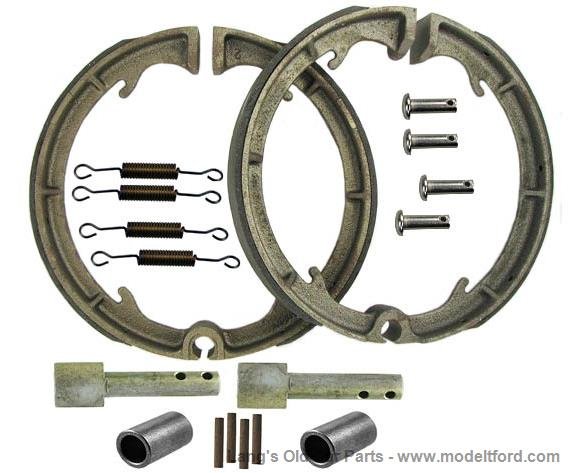

emergency brake.jpg (43.21 KiB) Viewed 3229 times

Posts: 3743
Last Name: Wrenn
Re: Weak emergency brake.
Post by TWrenn » Sun Apr 21, 2019 11:47 am
Since Scott posted his pic..I thought it would be a good time to mention to use the one piece brake shoe rather than the 2 piece set-up. Lately the 2 piece shoes have been a bit "oversized" and you cannot adjust it out, without them still dragging the drum in high gear mode. Trust me..I have a brand new set in the drawer that won't work. Had this happen on 2 different cars too. And heck, they're also much easier to install! And yes, some cars may still have the shoes with no linings. Get rid of 'em!
