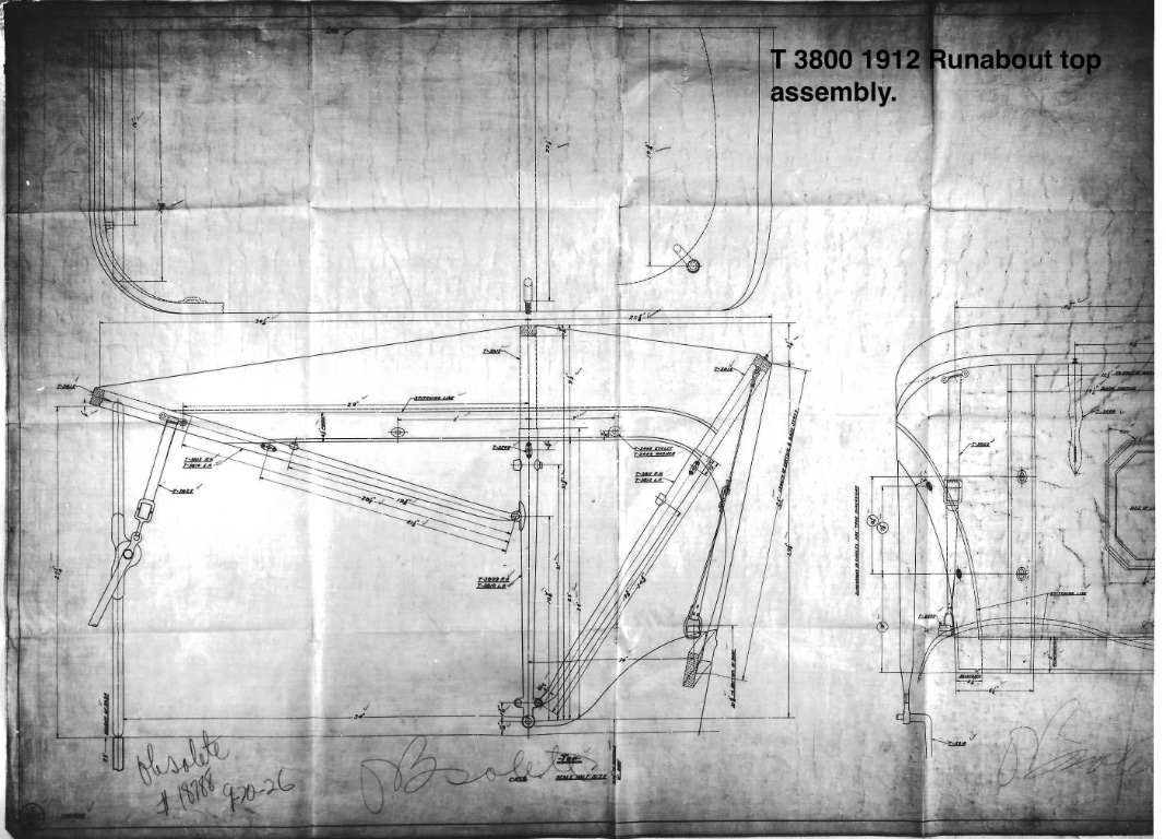

Believe the commercial roadster is the 1912 runabout, the lowered body, closed front compartment Torpedo likely used a different top assembly.
This is the T-3800 top assembly drawing for the 1912 runabout.

Distagon2
Re: 1912 commercial roadster top
How would one go about getting a better resolution file of the top drawing?
