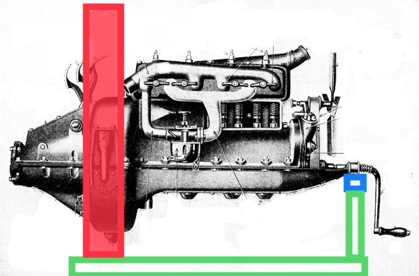

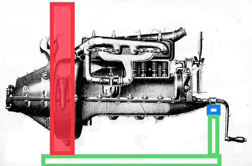

I have an idea for building a run engine stand that would rotate around the front engine mount using a old engine frame. This would not be ideal for pan/transmission alignment, but more of top and bottom end engine work.
Here are the design requirements I have in mind:
  • Radiator can be mounted- so it is a true run stand.
  • Engine can be rotated piston inspection can be up or sideways
  • Small/light/rigid for easy storage and loading of one person in a truck. Breakdown a plus.
  • Cheap- using old damaged Model T frame as parts would be a plus.
Other bonuses:
  • Throttle/timer adjustment
  • On wheels
  • Battery/Coil/Gas tank mount
Here is the basic concept of what I am thinking:
Before I move forward I would like to hear what you have used or seen.
Matt

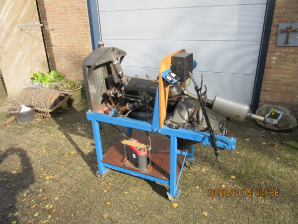

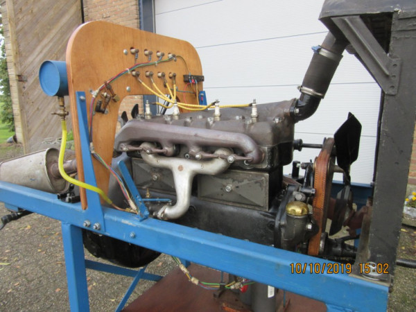

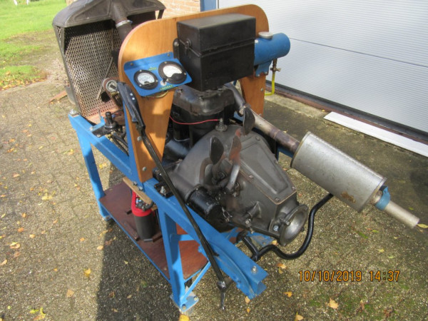

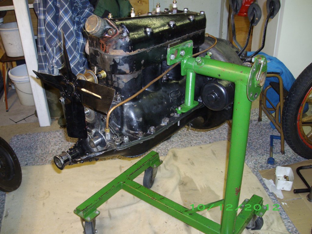

Matt , I use this as a Run Engine Stand .
Toon

Interesting idea. Scott is correct 3/4 of the weight of a T engine is above the center line of the crank so if that is the pivot point it will want to
flip head down so there will need to be some way to control the rotation. I have seen something like that in picture at the assembly plant?
Craig.
Craig.
I under stand the balance concern. I found the following info on the forum here:http://www.mtfca.com/discus/messages/11 ... 1281751326
Starting with parts that would balanced above and bellow crank shaft axis:
94.0 Complete 1926 Flywheel and Transmission Assembly
52.0 Flywheel/Starter Ring and Magnets Assembly
13.6 16 Magnets (Note 1 Magnet = 13.6 Ounces)
4.0 Starter Ring Gear
14.5 Coil Ring Gear
18.6 1926 Reverse/Low/Brake Drum Assembly
8.0 1926 Brake Drum
7.0 1916 Brake Drum
5.0 1926 Reverse Drum
2.0 1926 Low Drum
3.25 Universal Joint
2.5 1 Triple Gear with a Bushing
7.5 3 Triple Gears with Bushings
7.0 1926 Transmission Back Plate with Clutch Spring Assembly with Fingers/Adj Screws
4.6 1926 Transmission Back Plate No Clutch Spring Assembly with Fingers/Adj Screws
.9 Push Ring
3.0 Transmission Shaft
2.5 High Speed Clutch Drum
.5 8 Back Plate Bolts
17.0 1926 Crankshaft
267.45 lbs for transmission and other things balanced on center line.
Things above the crank shaft axis:
32.0 Transmission Cover with High Speed Clutch Assembly and No Pedals
31.0 Crank Shaft, Pistons, Valves, Valve Guides and Valve Lifters
78.0 Bare Block
26.0 Head
20.0 Starter with Bendix and Spring Assembly
15.4 Generator with Drive Gear
5.4 1925 Ford Exhaust Manifold (5.0 1916 Exhaust Manifold)
2.8 1925 Intake Manifold (3.0 1916 Intake Manifold)
2.25 Holley NH Carburetor
0.5 1925 Hot Air Pipe
0.2 Oil Tube
213.55 total for parts above crankshaft.
Things bellow the crank shaft axis:
35 Four dip engine pan and inspection cover
1.75 Front Ball Cap Bearing
1.00 Rear Ball Cap Ring
37.75 for parts bellow crankshaft
Thus we have about 175 lbs mismatch above crankshaft on a fully loaded engine. I am not sure exactly where the center of gravity is, but dropping the engine 3-5 inches bellow the spinning spinning axes.

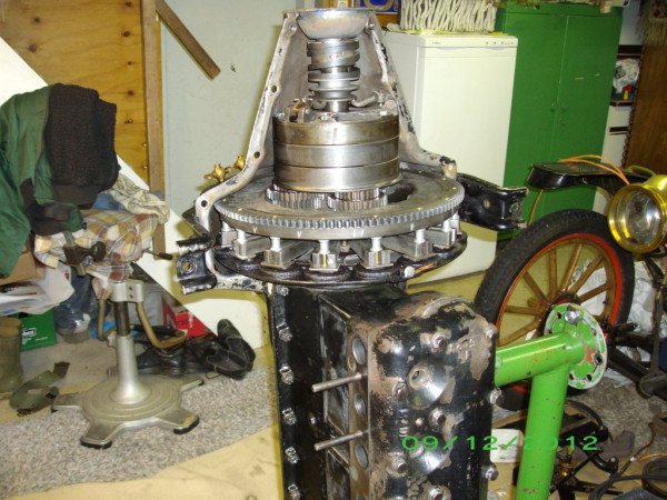

Matt in Call ;
To put the whole Engine together, I use this Engine Stand .
It can rotate 360 degrees .
Toon

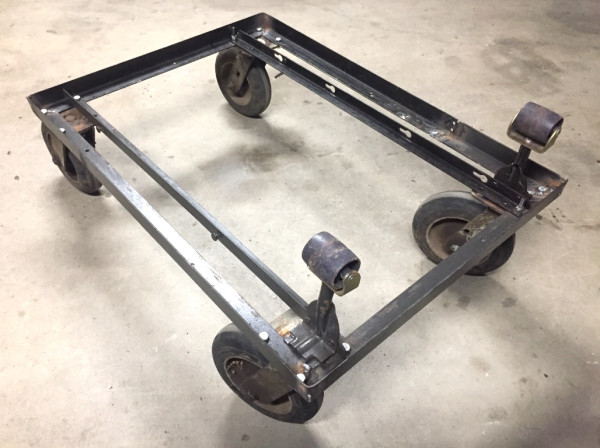

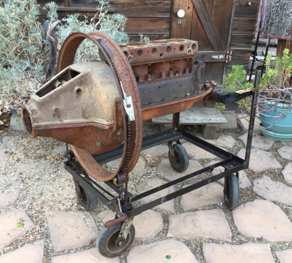

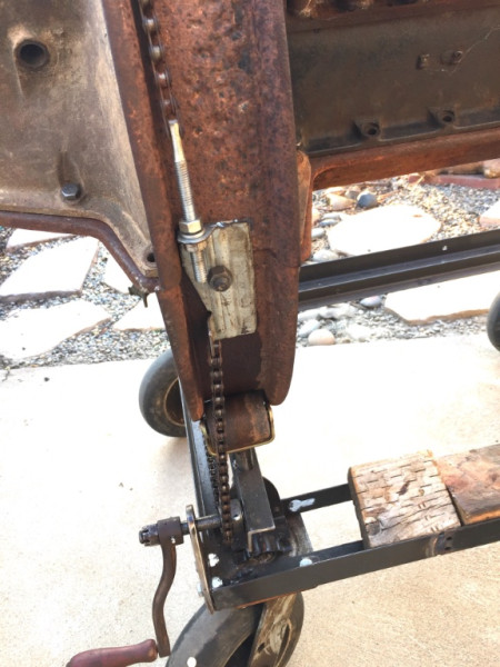

Post by Matt in California » Sat Sep 24, 2022 11:43 pm
I appreciate everyone comments. I can see the advantages of using an engine stand modified for a Model T. I can also see how a nice run stand is useful if a car is not available to test the engine.
My main purpose for this engine stand would be when I find a spare engine that hasn’t been ran for a long time I could work on it doing basic things like adjusting the valves or perhaps even removing the camshaft two a ream a valve guide or change the piston rings.

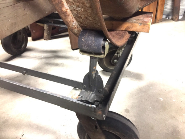

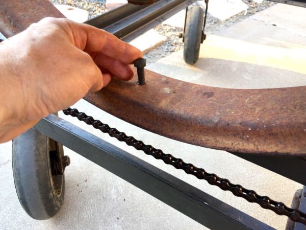

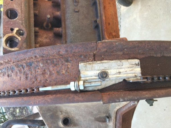

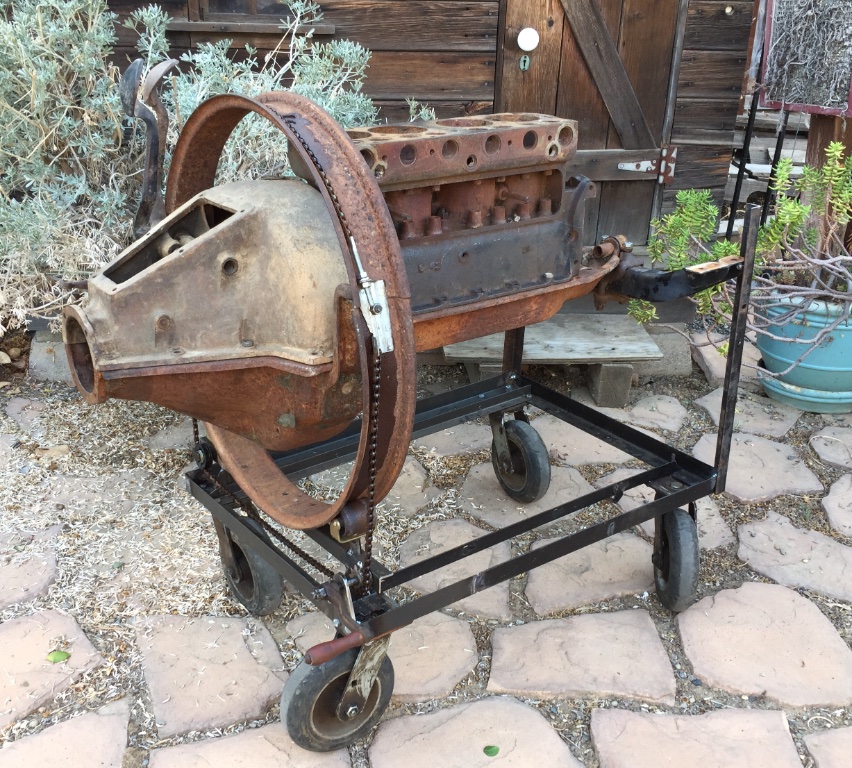

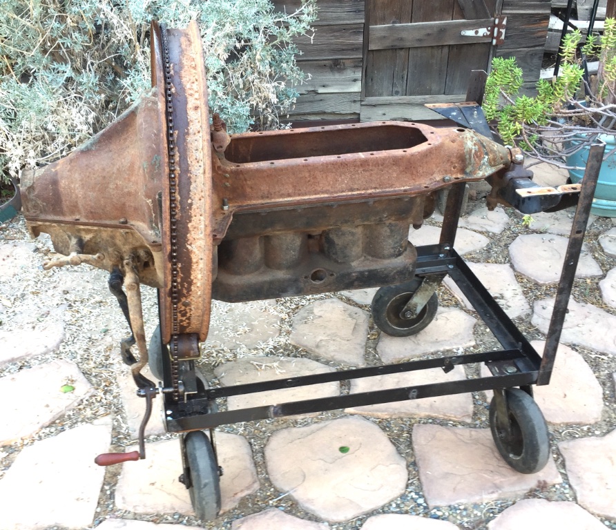

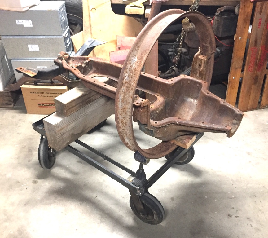

I might be stubborn, but I decided to give my idea a try. A neighbor was throwing out a bed frame, so I decided to use it for my base and even found a purpose for the casters!
Here is a progress photo:
Here is a mock up of the rotisserie engine stand just to see how things are fitting together. Obviously the boards would be removed the engine would be connected two brackets welded on the rim. I have some ideas for the front of the engine still gathering parts for that.
One of the benefits of using a bedframe on this project is that I am learning how to sharpen drills on my vertical belt sander. :lol: Bed frame rails are very hard. I start with an 8th inch drill in the step up to more steps. I’ve had to sharpen the drills multiple times for the dozen holes I drilled. I welded the base frame together. I attempted to notch and bend the frame but it would crack, so I had to heat it with a torch to bend it. Fun stuff. I figure worst case scenario it will make a good base for a run normal engine stand.
I appreciate your comments and suggestions.
Matt

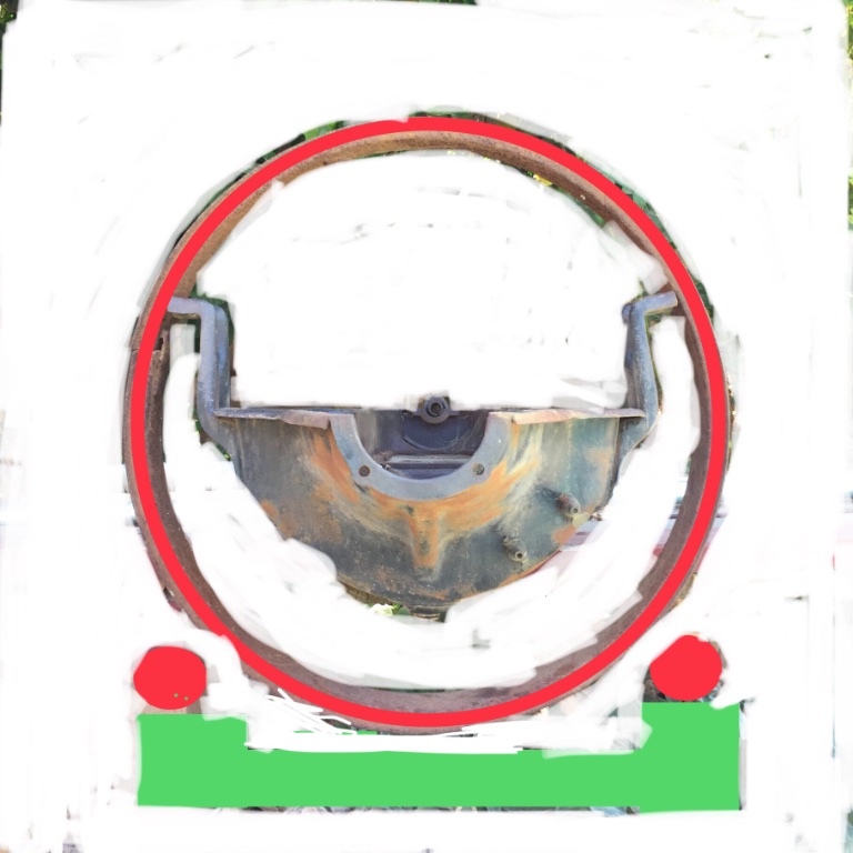

The only problem I can see at the moment is the line of rotation. Your mounting points will put the center of gravity too low making the assembly top heavy. If you check the engine stand picture posted by ABoer above, you can see the point that the engine rotates on that standard stand. This line of rotation makes the top and bottom weights roughly the same so spinning the engine around the mounting axis is not much of a battle. This point on the block will be close to the point that you will need to rotate your engine - although 90° to this to get the longitudinal spin that you are after.
Mounting to the engine "ears" and "nose" gives you solid points to lock down the engine but the horizontal axis will have to be somewhat above them again to put half the assemble weight above and below the line of rotation. Spinning around on the crankshaft axis will give you a top heavy assembly. It will certainly be easy to rotate the head down to the bottom but getting it back up again will be hard work that can be reduced by balancing the weight more evenly.
Maybe thinking about an auto body rotisserie will help explain what I'm suggesting....
https://www.redlinestands.com/catalog/s ... 7_328_212/
Of course, this is only an observation from someone who has never heard, built, or even seen a horizontal engine stand until you build yours. Looking forward to seeing your creation in operation.
Joe

Post by Matt in California » Sun Oct 16, 2022 10:46 pm
Thanks for all the photos and suggestions!
Here is an update on my progress. I did attempt to find a way to make the engine more balanced, but decided to just keep it simple.
Easy to invert the engine.
Hand crank mechanism consist of chain that I got from the garage door the mechanism and a crank handle probably from old grinder. The chain looks to be about the same as a bicycle chain. The gear ratio seems perfect as it is not difficult to turn.
This is the part that connects the chain to the door. It worked great to tighten the chain.
As suggested I use a bolt to lock in position. I will drill more holes when I determine where I want to lock it.
This has meet all my goals. It is light weight and could easily be transported in the trunk of my Saturn. And with the large wheels I can easily roll it over large rocks and gravel in my back yard.
I am still testing it, but like the results that I am seeing. There is still work to be done to run a engine on it.
Matt
Posts: 5599
Re: Run engine stand that rotates- want to see what you have before I build mine
Post by RajoRacer » Sun Oct 16, 2022 10:54 pm
Quite ingenious there, Matt !

ABoer’s takes the cake for me. Pan off is what did it. About as simple as it can get with totally full access.

That would also be handy for cleaning up an engine unit prior to rebuilding.

I’m coming in a little late on this discussion but thought I could share an idea that I have benefitted from. A few years ago Gail Rodda suggested that I purchase his portable engine running stand. He built this years ago for the purpose of starting and running in freshly rebuilt handcrank T engines. It utilizes the front section of a T frame but has the addition of a hinged portion at the rear that has a 3/4 HP , 19:1 electric gear reduction unit with a Bush Hog clutch (like utilized on a tractor mower) and custom drive shaft. The drive shaft has a 1” square end that simply slides into the transmission like the T u-joint. I usually remove the spark plugs then turn on the electric motor and easily turns over the motor. I have the radiator and everything connected but simply leave the coilbox and gas turned off for this initial run in. Yes the engine does generate some heat from friction. After about 15 minutes I reinstall the plugs, turn on the fuel and switch the activate the electric motor. It pops right off and quickly overrides the Bush Hog clutch without any issue. I switch off the electric motor and let the engine break in. The frame has a coilbox, small gas tank, throttle and spark control and new flat tube radiator. The gear reduction unit has not problem turning the new motors over even with hi compression heads.

Charlie, I agree that an engine stand that attaches to the block and holds it vertically is ideal for assembling an engine. The idea here is a run engine stand that rotates. I was wanting to build a run engine stand that is versatile.
Mike that sounds like a good idea when adjusting rod caps or initially running a engine.

One suggestion on your chain- one wrap of the chain will limit your rotation to less than 360 degrees. You might consider two wraps of chain that will allow you to go all the way around with no restrictions.
