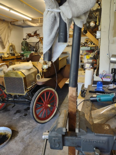

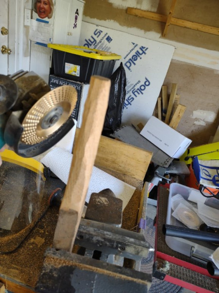

is there an easier or correct way to trim bows? How long should the bows end be trimmed?
I am shaving the top bows ends to fit the top irons by using a grinder with wood cutter wheel.
Is there an easier or correct way to trim new bows?
How long should the bow end be trimmed to slipped onto the bow? I estimate 6 inches........?
Thanks!
Thanks!

Use a spokeshave and take off a little at a time by hand.
- Posts: 7260
Re: is there an easier or correct way to trim bows? How long should the bows end be trimmed?
Grinding/sanding across the grain like that will make the job difficult. A draw knife will be better for bulk removal, and a spoke shave for more accurate finish work. Then sand along the grain to get a neat fit. There is no tear-ass quick way to get a good fit that I know of.

I have used a power hand planer and belt sander with a 36 grit belt to sculpt until close on jobs like this, but a spoke shave or draw knife is the more cautious approach.

The difficulty with any power tool is maintaining control of the process. It is vital that the bows are as good a ft as possible if the top is to sit/stay correctly lined up. Getting the bows to sit at the right height, with maximum support within the socket, takes time and effort. This task is the foundation of the top, and a neat installation that will hold the correct line, demands that attention is paid to detail. It took me hours and multiple fitting trials to get the bows lined up on my 1915 tourer.
