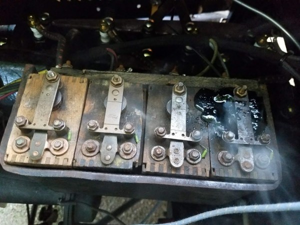

Coils leaking tar
Is it normal for wooden coils to leak some tar out? All 4 coils on my 15 leak enough tar to stick together. Over time it leaks enough that I have to take them out and clean them off and clean out the coil box. The tar will get on the lower contact in the coil box and cause that cylinder not to fire. The car is a 1915 with a 1925 engine. Coil box is mounted on the dash as it should be. Exhaust pipe is wrapped to keep the heat down. Heat shield is in place under coil box on firewall as original.

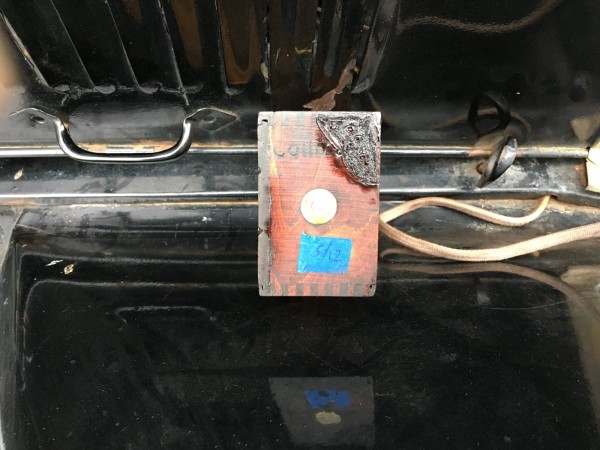

I’m not 100% in agreement that the coil leakage is totally due to the quality and/or type of tar used.
This photo is a coil the failed on Dec 24, 2016. You can easily see the leakage. Now, look at the blue tape that I placed on the bottom with the date of 5/12, which is the date of the re-build. It was rebuilt by a highly respected member coil-guy type re-builder. He has re-built several for me over the years.
Here’s my question- If the failure was due to poor quality TAR, then why did the tar in this one wait 4 ½ years of touring in hot summers before it decided to melt on a cold December day? Just wondering.

Good question. Most of the “leaking” I’ve seen is small amounts of a thick sticky/oily substance that seems as though it precipitates out of the tar and leaks out of the box. I have only seen small spots of regular tar outside the box a couple times, but nothing like you show in your photo. I’d be curious to know whats really going on there. I do have a couple ideas, but not proven, so I’m not going to mention it here.

I had a coil over heat on my '27. Apparently the cover was on crooked and one of the clips on the cover that hold the coils down caused a short. With the cover on properly I had no further problems. I replaced the coil though.

John- that lid cover being mis-aligned makes sense.
