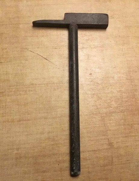

Post by jiminbartow » Mon Sep 19, 2022 11:25 am
Good morning.
I found this spark coil hammer 15 or 20 years ago, in my Dad’s shop. I would not have known what it was for, had I not seen a picture of it in, I believe, the Model T Essentials book. Many of you may recall that I posted it on in the forum way back then and then it went missing. I was distraught over the loss because I believe it is a one of a kind tool important to the Model T history. I was cleaning out my ‘26 coupe when I found it in the trunk wedged in the corner and thought I would re-post it. It is the only actual one I have ever seen. Does anyone else have one? Why are they so scarce? Did folks just throw them away? Exactly how is it used in the adjustment of the spark coil? Is the long piece used as a little pry bar? Thank you. Jim Patrick

What a Find!
yes, the little end is a pry-bar to undo what the hammer end does (if it did it too well!)
Bob Scherzer reproduced those some years ago and a version of this can be purchased from Lang's. Yours is the only one I've ever seen that appears to date back to "T" days.

Yes it has a beautiful hundred year old patina. While millions were probably made to sell to the 15 million Model T owners, it does not appear that many, if any, besides mine, survived. Maybe they were considered to small to be of any use.
If I recall, I sent a tracing of it as well as measurements to someone (yes the name Bob Scherzer rings a bell), who wanted to make reproductions to sell to other members at the “Fun Projects” store. I guess that project petered out, if it ever got off the ground, but a search might reveal the thread trail regarding my first posting and if reproductions were ever made in about 2005. Jim Patrick

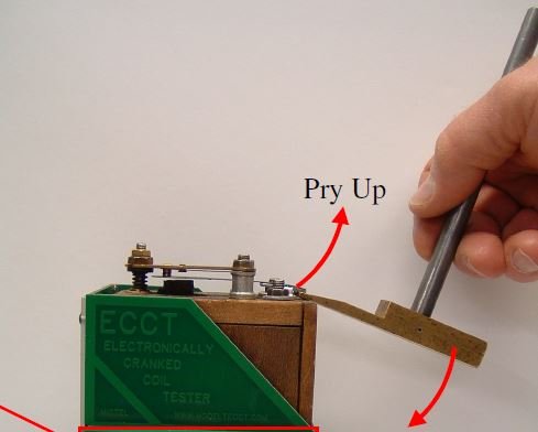

Here are a few examples on how the coil adjusting tool is used. The goal in adjusting Model T coil points is to set all coils for equal and consistent firing Time.
Tap down on the rear vibrator spring to increase the dwell time to fire spark:

Pry up on the rear vibrator spring to decrease the dwell time to fire spark:

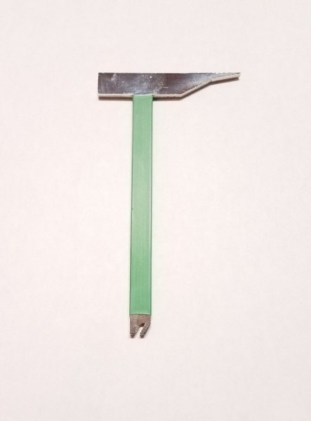

Here is a modern version of a 3 in 1 coil adjusting tool I make that combines all 3 functions in one handy tool:

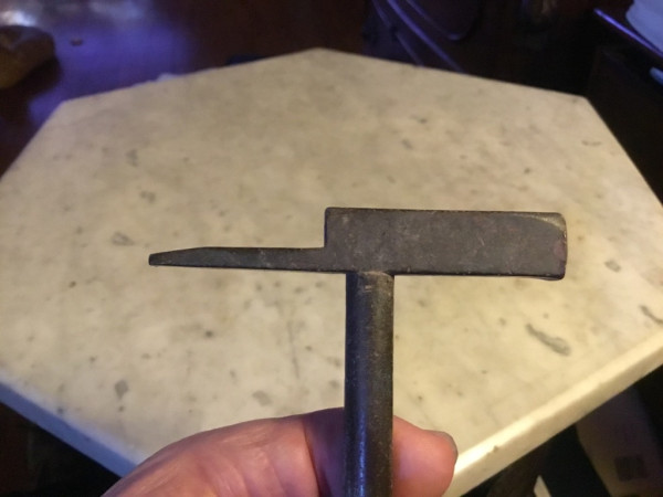

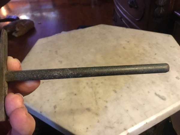

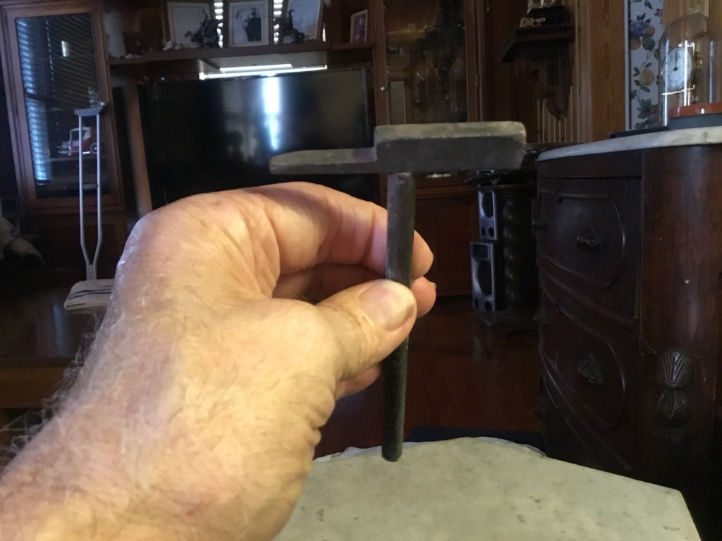

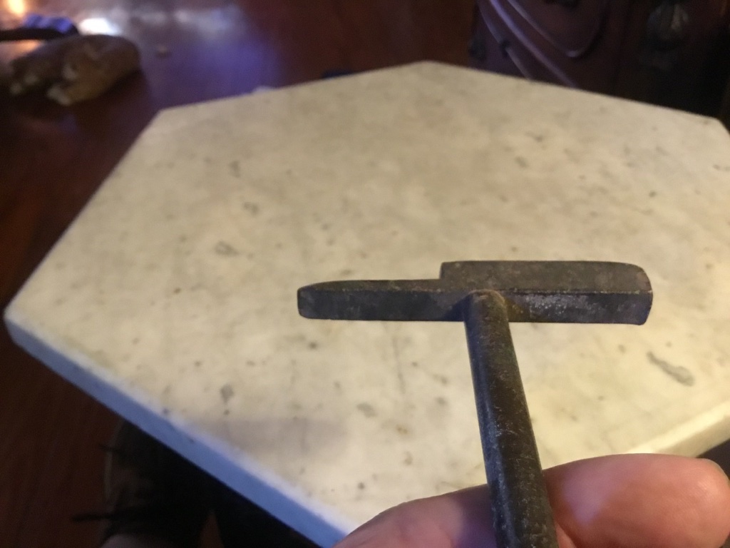

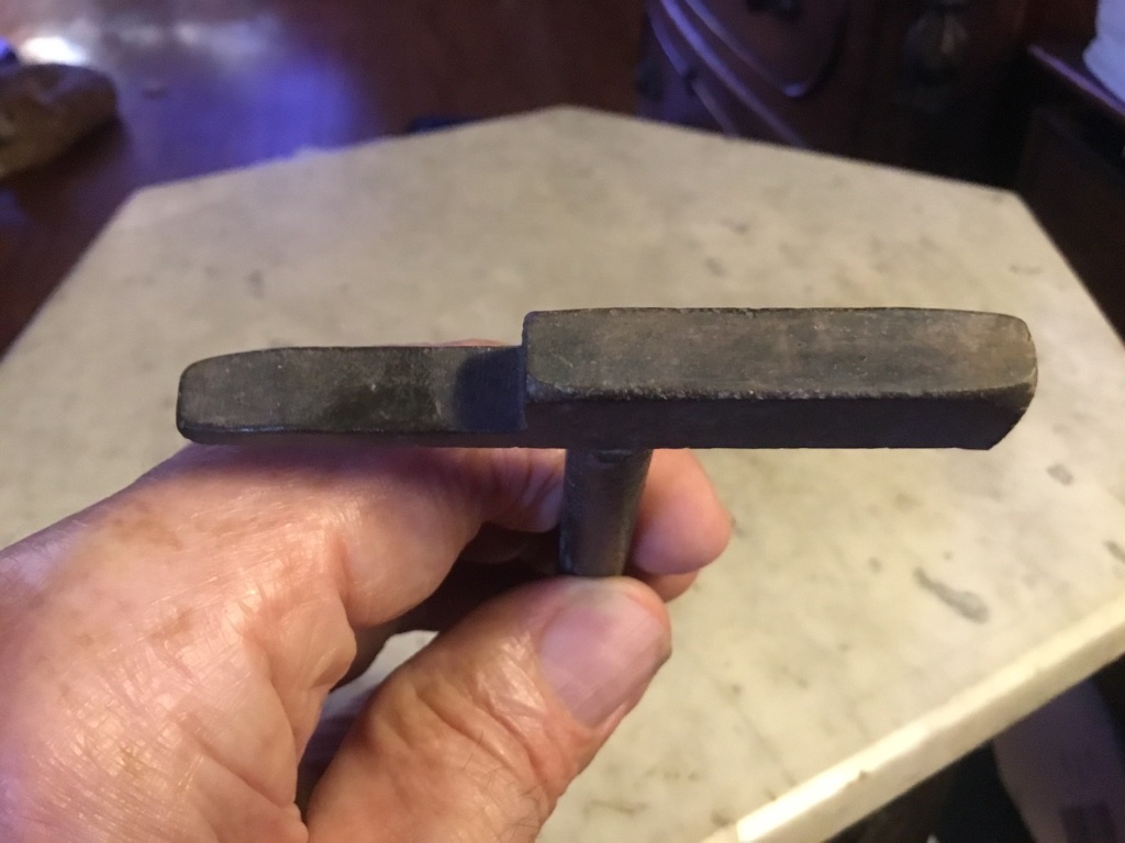

Jim.. could you post some better close up pictures of that tool?
jiminbartow
Posts: 2480
Last Name: Patrick
Location: Bartow, FL
Re: Spark coil hammer
Post by jiminbartow » Mon Sep 19, 2022 4:38 pm
I’ll try. Any particular parts you are interested in seeing? Jim Patrick
jiminbartow
Posts: 2480
Last Name: Patrick
Post by jiminbartow » Mon Sep 19, 2022 4:39 pm
Here are a few more.

So now I'm wondering if the hammer I got from Lang's has the handle installed 180 degrees backwards OR that original hammer handle came off and was reinstalled backwards...
Posts: 2967
Last Name: Hjortnaes
Location: Men Falls, WI
Post by DHort » Mon Sep 19, 2022 5:16 pm
Mike
You probably have the metric version.

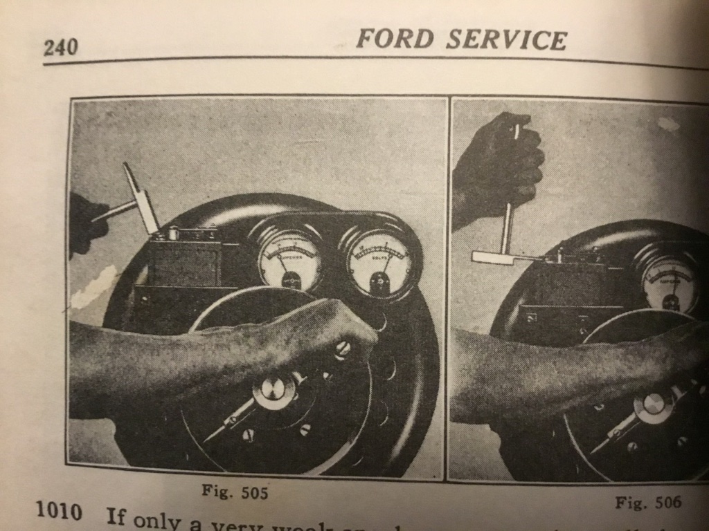

I went through my books and found a couple of pictures of the tool in use on page 240 of the “Model T Ford Service Manual”. Jim Patrick

Well, that settles it, the repo version is built backwards with respect to the original. :o
Go figure. At least that makes the repo coil hammer easily identifiable as such.

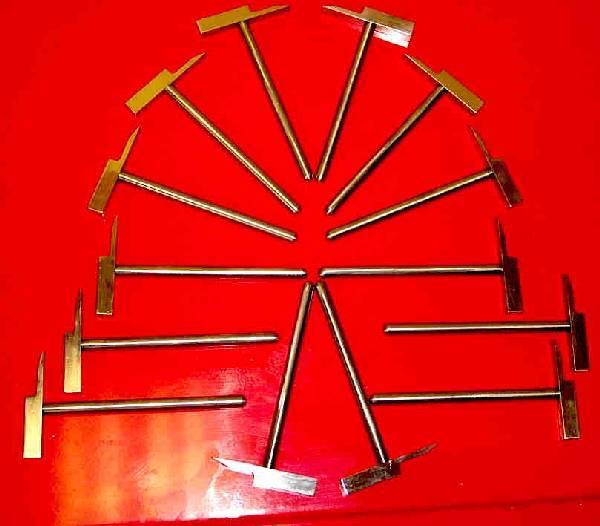

Here is a picture that Bob Scherzer took and posted of several of the coil adjusting hammers he made in 2007 based upon the dimensions I provided him. They look good. In his post, he said at the time, he was selling them for $30.00 apiece which included shipping. These are not made upside down like Lang’s hammers, but are made correctly like the originals. I don’t know if he still makes them. Jim Patrick
