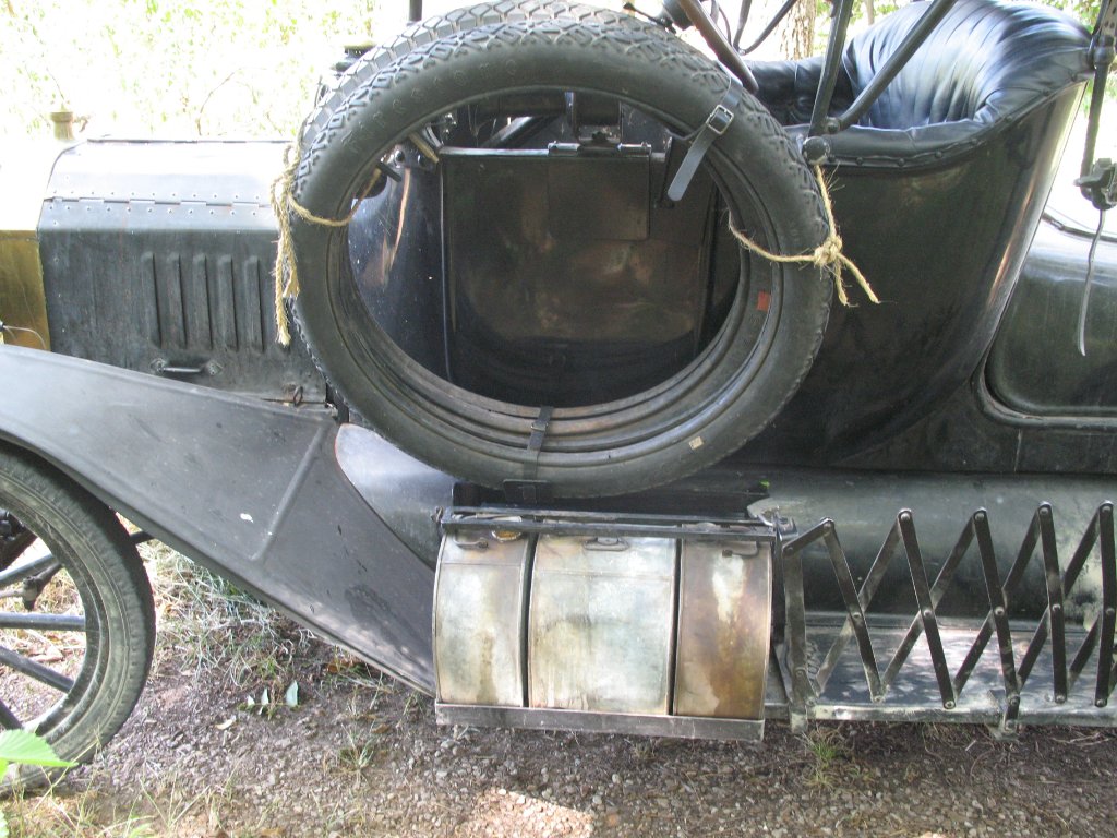

I asked some well-known Model T rebuilders/experts who drive a lot what oil they use. The two answers were 20W-50 and 15W-40 (Diesel). I went with the 20W-50. I've been buying quarts of it to carry in the car, getting it at Walmart for the best price. That is ending. I'm told Walmart is deleting the heavier oils and going with only the light weight oils required for late model cars. On my recent trip I found a few stores that still had quarts of the 20W-50, but that won't last long. Most had already sold out of it. The remaining quarts will soon be gone, and I figure the gallons will go too. So I will switch to the 15W-40 they still sell (Rotella by the gallon or the house brand in two-gallon jugs).
But what about traveling? A gallon or two-gallon container will take up a lot of the limited space in a runabout. What to do? The answer is on the running board. I have always carried gasoline in all three running board cans for a total of 7 gallons (2+3+2). I'll change one of the two-gallon cans to oil and not have to carry any at all inside the car. That will still leave me with five gallons of gas that will be good for well over fifty miles of driving.
Water? I don't like the idea of water in a steel can. Even galvanized pails rust out. Water will continue in a plastic jug inside the car.
#3 will become oil.
#3 will become oil.

I like your idea of oil in one of the running board cans, BUT if you want to carry more gasoline, just save your quart oil bottles and fill them from the 2 gallon jugs. Then you can take however many quarts you wish. The big problem will be finding quarts on the road. Sounds like there will be plenty of gallon, 2 gallon, and 3 gallon jugs out there.
