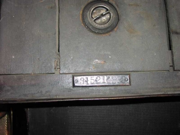

It goes on the wooden frame under the front seat cushion, just in front of the gas tank cover.
I believe the first digits are the month and year. It is a body number. Do you know the body manufacturer?
http://www.mtfca.com/discus/messages/29/6661.html

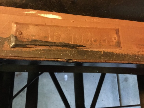

My 1915 body # plate is on the top if the front seat riser as well. The first three digits are the month and year of body manufacture... mind you, not car assembly, but body manufacture. Mine is a January 1915 touring body made by the Beudette(sp?) Company, a subcontractor for Ford. See the pictures below. Do you have a stamped 'B' on the face of the passenger side of the front seat riser? In that case, you got a Beudette too.

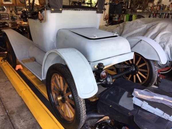

Topic author - Posts: 277
- Joined: Wed Jan 16, 2019 11:38 am
- Last Name: Chochole
- Location: Oswego, Illinois
- Board Member Since: 2003
Re: Location of 1915 body serial number plate?
Okay retro, I'll shoot some pics tomorrow.
- Posts: 6600
Your car was built 4/16, so I'll bet you'll find two small holes that that tag fits.

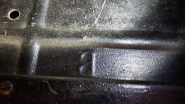

Mine is stamped in the wood next to the passenger side of the floorboard... shows the car was built in August '15. Starts with the letter "F" meaning it was a Ford body, not a Beaudette etc (which I understand used the tags)... Interesting sidetrip on this is our DMV is loathe to use the motor number for the VIN (6 digits??) and will require those cars to use one of their "assigned" VINs, but will use the the body stamping (12 digits counting that first "F") and call it a legal VIN (meaning I don't need one of their ugly "assigned" VIN stickers...)... At least for now.

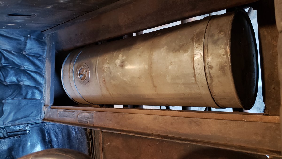

My 1916’s engine number puts it early Feb. 1916. The 3 16 xxxxxx plate on the seat frame puts the body a month later.

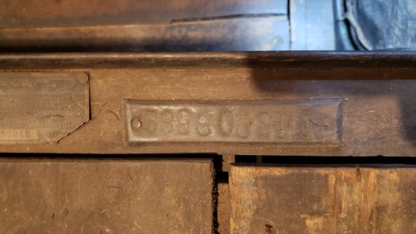

all good stuff. Just for info, my car was built 11/15 and has a "W" stamped in the steel heel riser (Wilson), has a steel seat pan, and the body # is stamped in wood on passenger floor riser (angled wood supporting floorboard). I recall it is W 11 15 XXXXXX (I am including what I recall from memory)
