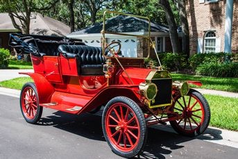

There is a fantasy 1910 T touring on Hemmings auction. I do not see any 1910 parts on this car. The brass is all reproductions. The chasis is much later. The repro fenders are the wrong style. The body is a new build and all wrong. The current bid is $15,000 which is all it might be worth. Take a look and have a good laugh.

Here is a photo.

While I am no expert by any stretch of the imagination, even I can see some of the peculiarities. Is this one more like it should be?

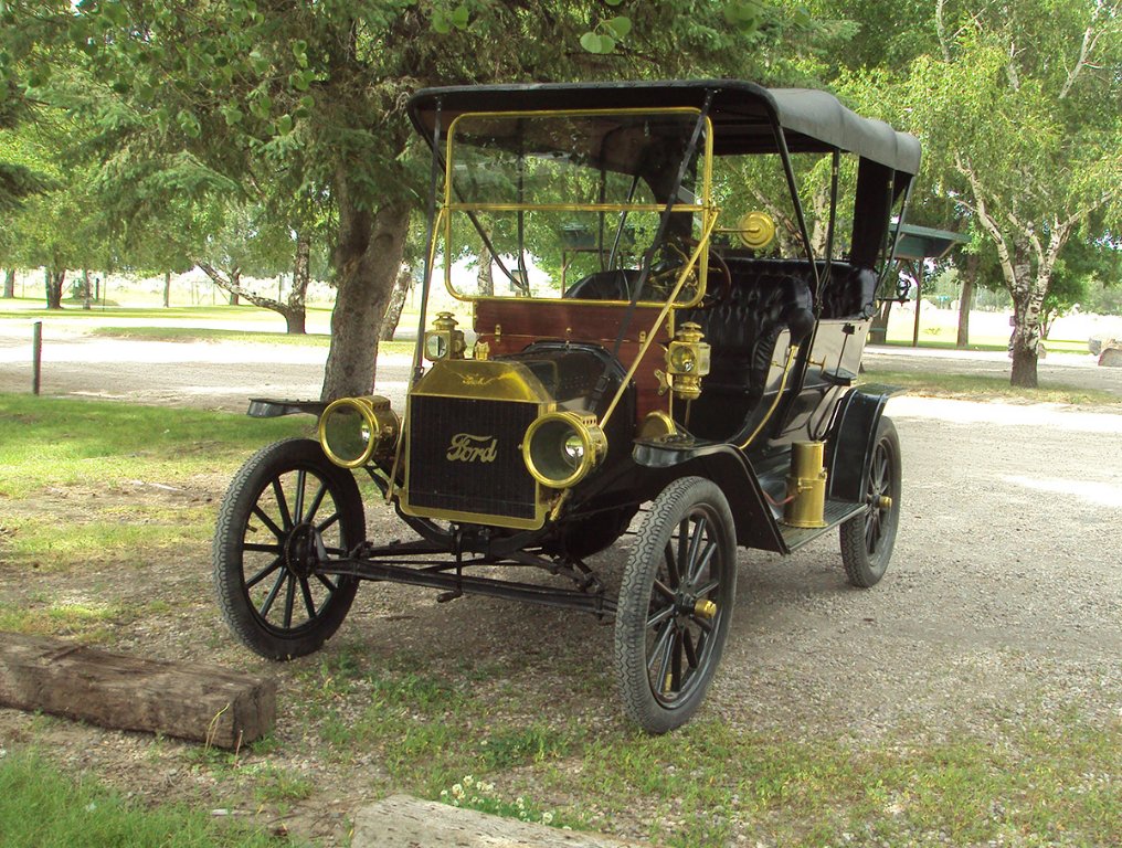

Yes the second picture is of a more correct 1910. The color is wrong, all or most all were painted brewster green. 1909s were mostly red, but there were some pearl gray 09s and tens.

It sure is a clean looking build with a lot of money and work invested. You get that early car look with the ease of a late T and A transmission. Not for the purist but it's pretty neat and it looks like a lot of fun!

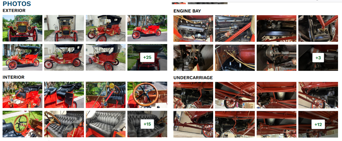

for the Magpies that don't know how to search for this to pick it apart, here it is: https://www.hemmings.com/auction/1910-f ... l-t-532879

But it Does have a low head and brass hub fan

As fantasy early brass Ts go, this one isn't all that bad. It certainly is better looking than the over-grown Shriner's roadster shared a couple weeks ago. the general look of the car is good, in spite of nothing being really right. If someone decided to call it a 1911, even the fenders would be close. Of course that makes the color red even more wrong by one more year? But there are so many red 1910 through 1915 model T touring cars anyway? The body's dimensions and offsets aren't right (and that square cornered door!), but for a fantasy car it looks okay.
The Madison Avenue writeup turns me off more than the car does!

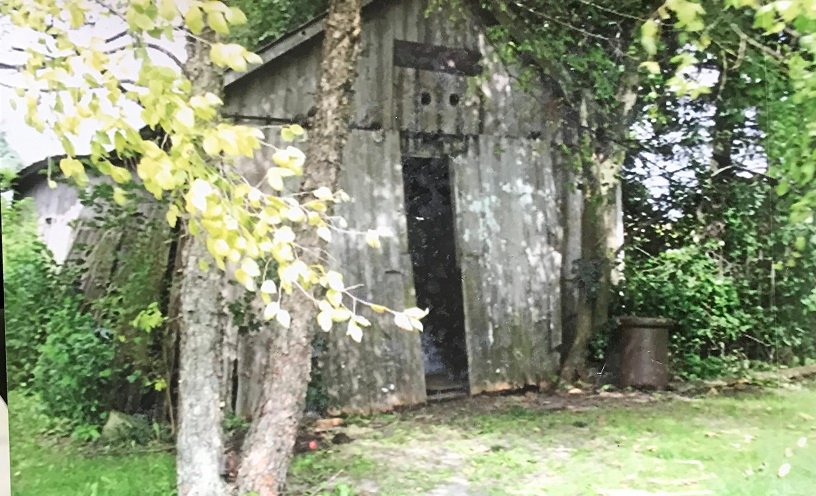

What is "original"?
At first its called a "barn find", then a "survivor", ... 16 video segments have been made documenting its cleaning, repairing, replacement of top, seat material, etc as instructional training aids & establishing provenance of this vehicle being maintained to its "Original" what? Purchased, when driven into the shed, it no longer looks like the barn find or a survivor, is it now re-manufactured, restored , rebuilt? None of those "r" words indicate that 99% of the "parts" are original to the vehicle - how important is that?
This car that sat in a shed from 1915 until 2018. The history per the original owners son said his Dad lost control of the car and dented a front fender. Then drove it into the shed below in 1915.
-- -- The first picture is the Ford dealership where the car was originally purchased (its not one of those cars)
The picture below it is the same building now the City Hall of the Town. The Model T is "The T" --
The T was completed this year , more photo's of it are available as it is available for purchase

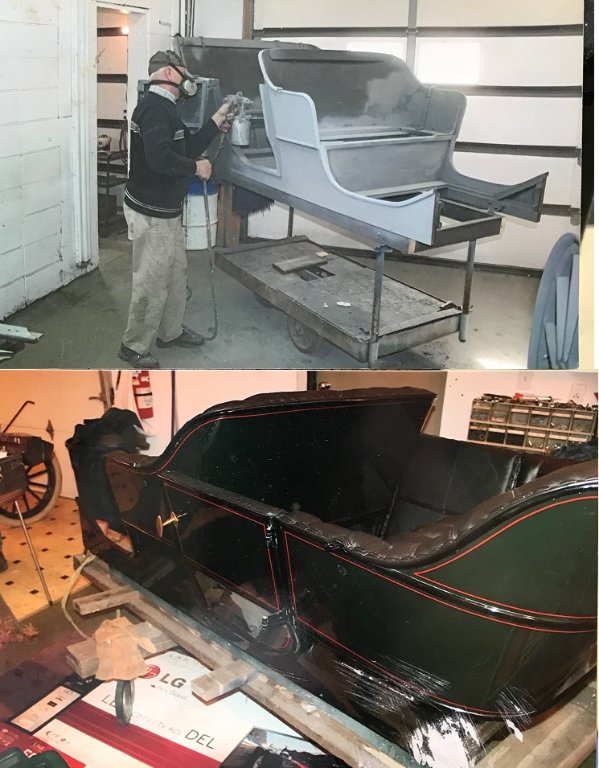

This is the car back at the shop prior to "Maintaining its aesthetic appearance" & mechanicals --
The process to "Maintaining its aesthetic appearance" begins -
The T was completed this year, more pictures area available as is the car

The green is nice, but the paint hides the grain of an original varnish .

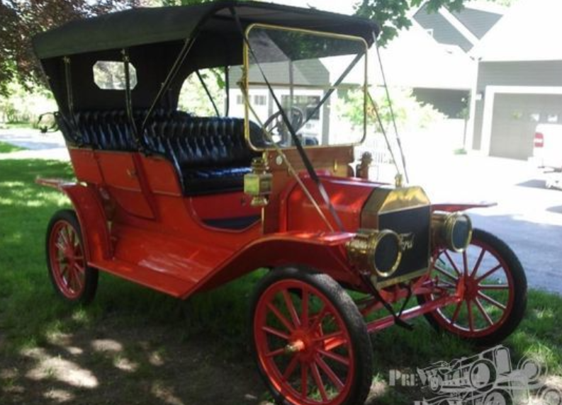

When I built my 1909? I had about $7000 in it. I bought new sheet metal, radiator, windshield and top irons. The brass lights and acetylene generator were picked up at swap meets and restored with some homemade parts. I spent a lot of time researching and drawing up body plans. The chassis is mainly 1913-14 with a 1920 engine that was rebuilt in the 60s and used in my Speedster until a crankshaft broke. The babbit was fitted to another crankshaft. I crafted the top and seats myself with new springs. I don't try to pass it off as original but believe it is very close looking to one. I can drive it without worries of ruining more valuable parts. Most folks that see it or ride in it don't know or care about the discrepancies. Since I can never afford some of the cars I would like to have this is a great compromise for me. We have enjoyed it for 20 years and a few thousand miles. I have a 1907 Buick which we have only driven a few hundred miles in the same amount of time because of its rarity. To me it is the best of both worlds.1925 Touring wrote: ↑Thu Sep 22, 2022 10:06 amI wonder how much cheaper the car was to restore to non purist condition instead of going through parts and finding the correct pieces.

That is a very nice touring car! I love the look of the Brass Model T's and hope to own one like yours someday.I don't try to pass it off as original but believe it is very close looking to one. I can drive it without worries of ruining more valuable parts. Most folks that see it or ride in it don't know or care about the discrepancies. Since I can never afford some of the cars I would like to have this is a great compromise for me. We have enjoyed it for 20 years and a few thousand miles. I have a 1907 Buick which we have only driven a few hundred miles in the same amount of time because of its rarity. To me it is the best of both worlds.
I think that is the beauty of this car. (The topic car.) I didn't think much of it before, but as you go through the pictures online, yes, there are a lot of parts that are not period correct. But as Rich said above, as did I, that is the beauty of this car. You have the Early Brass Era car look, but without (as much) worry of ruining as many early parts. (Not to say we should go out abusing 26-27 T's, or any in general.) It would be able to go on tours, or go a few hundred miles, and have fun.
As long as the new owners like it!

Then there is the description of the car included in t he offering https://www.hemmings.com/auction/1910-f ... l-t-532879
POWERTRAIN
The 177-cu. in. L-head inline-four cylinder engine that powered Ford Model Ts was rated by the manufacturer at 20 horsepower when new, with 83 lb-ft of torque at 900 rpm. The seller notes that the engine in this car originated from a 1917 Model T and was thoroughly rebuilt during the restoration. A three-speed manual transmission from a Ford Model A was also installed during the restoration, “to increase low speed drivability and assist in hilly terrain.” The engine is said to start with no smoke and idle very well. No leaks or weeps are reported. The transmission “shifts fine,” with no unwanted noises.
CHASSIS
Photos of the undercarriage appear to show that it has been restored and maintained to the same high standards as the exterior and interior portions of this fine Model T. The rudimentary transverse leaf springs on both the front and rear axles reveal a suspension design that Ford continued to utilize until postwar years. No modifications have been made to the undercarriage, and no suspension service has been needed since the restoration. No issues are reported either with the brakes that “can lock up the wheels.” The 30-inch wooden spoke wheels are finished in red with black pin stripes matching the body and fenders, and appear to show no signs of damage. The Firestone Gum-Dipped tires are described as 12 years old but appearing to be “like new."
Notice the Title given to the car at auction "Restored Brass Era 1910 Ford Model T Touring" It does not say Restored 1910.
POWERTRAIN
CHASSIS
