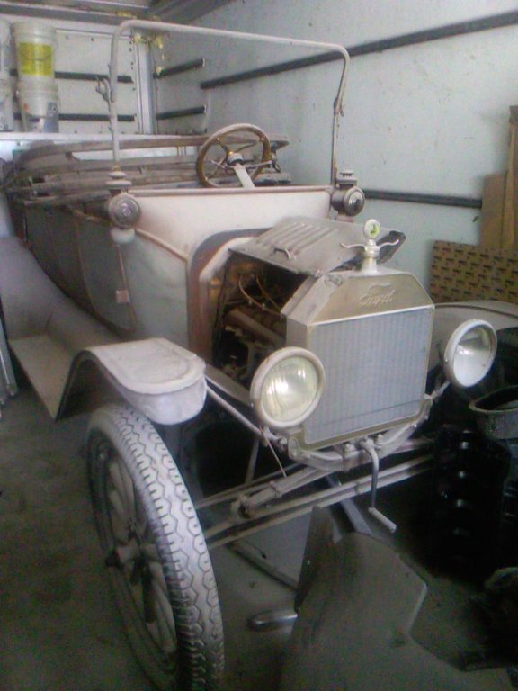

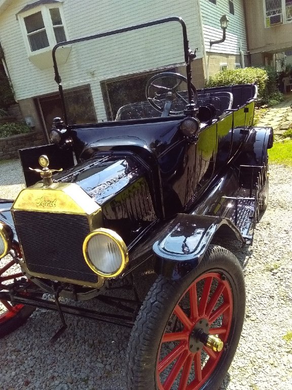

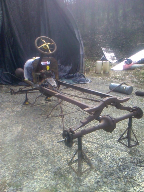

This is my 1st T. 1916 Touring. It was a rust bucket when I bought it, took it down to the frame, did not have to remove the engine, had good radiator, wheels & tires. Had to replace the king pins and a few other things while the body was off. Had to remove the hog head and replace some bands, would only go in reverse when I bought it. I only had 2 good coils out of 7, had to learn how to fix and adjust them. I had to jack it up when I bought it to start it, drained the oil, almost as thick as tar, added Kerosene and let it soak a few days, put an Aerator in to make bubbles, put 10w-30W in and now I can start it, most of the time with 1 crank, even after setting a few weeks, and do not have to jack it up. I have posted many questions, thank you to all those that took the time to answer them. Drove a couple miles on the back roads today, I am 72 and it is like learning to drive all over again. I live in the hills near Indiana, PA, I have to learn to climb the hills and more of a challenge is going down the steep hills and not loosing it. Next is the interior & top. The large nut between the tail pipe and the manifold will not stay on. The treads on the manifold look good, the nut will start but not stay tight and eventually fall off while driving, I have attached a picture, any suggestions?

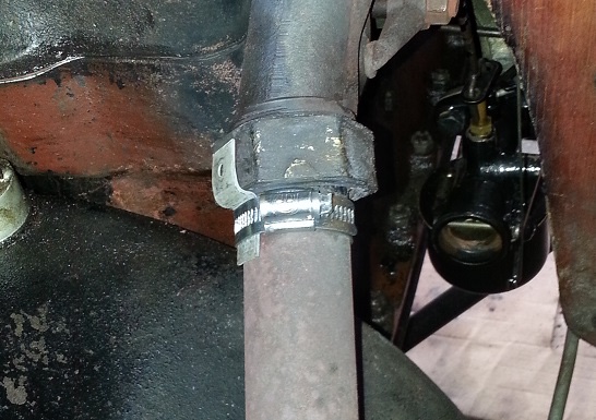

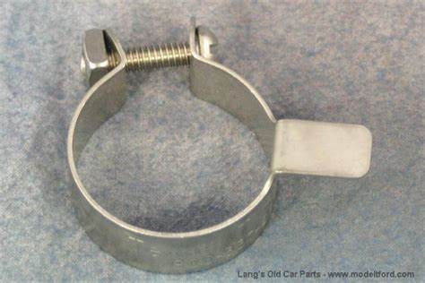

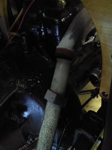

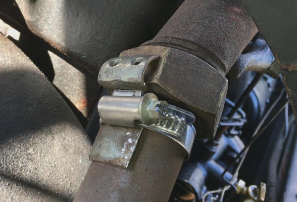

Attached are 4 photos showing two methods we use to keep worn exhaust pack nuts tight. The first is with a clamp with a built in fold down tab, made for the purpose. This is available from the vendors. The second is a do it yourself method using a pipe clamp with a home made bracket. Tighten the exhaust nut as tight as you can, then install the clamp of your choice. Jim Patrick

that is a really nice looking buggy! You've done a nice job.
as far as going down hill and not "losing it", you ALWAYS go down a hill in the same gear you'd have to go UP in. Anything else will be hazardous to life and limb.
