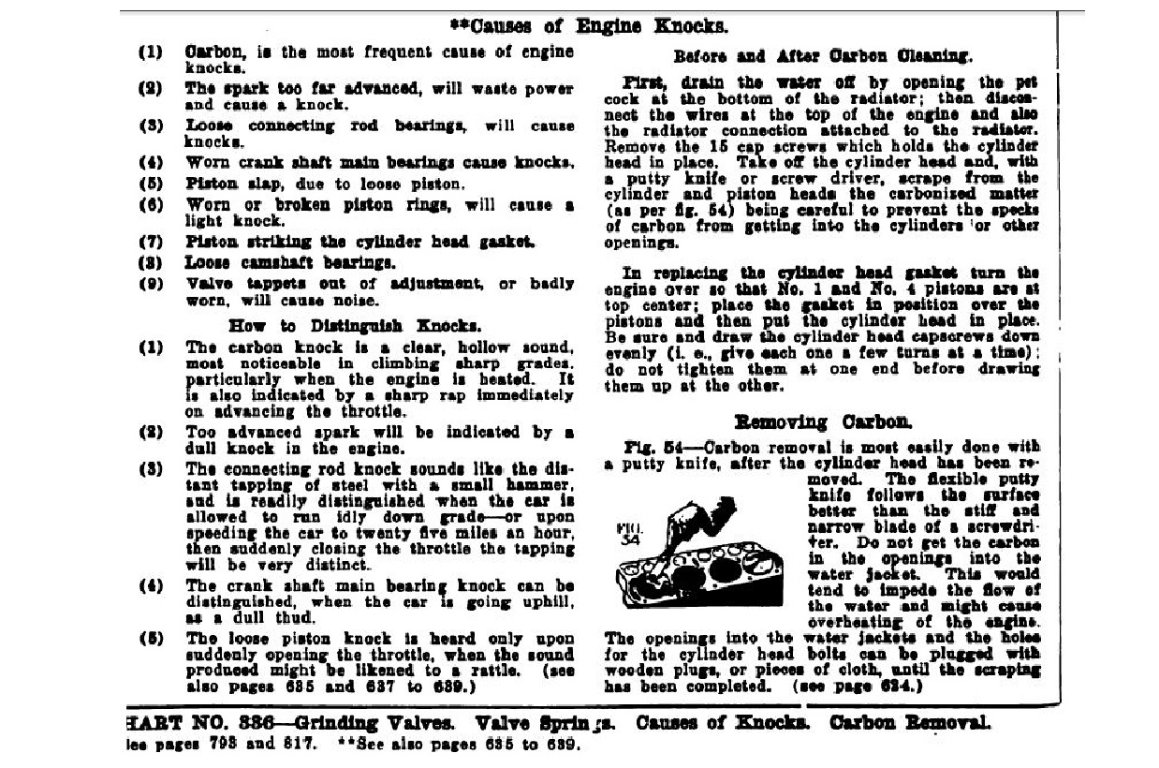

Back in the past there has been a list posted on this forum of possible causes of specific engine noises (knocks, taps, rattles, etc) that we hear from a Model T engine. Example: a tap that is heard at moderate speed, with no load. this list would be a starting point- not a sure fix.
This list detailed the most common noises and the "possible" cause of the noise. Can someone re-post the list? I want to save it this time!

Re: First things first! Engine Knocks
Here's one that was sent to me by email. I don't know the source.

They all make some unusual noises, and the firewall and floorboards are not insulated as in modern cars, so the noises are more audible in a Model T. Some of the noises are just vibrations. Such noises as brake rods under the car as you go over a bump or the vibration of the choke or carburetor adjustment rod where it goes through the firewall or dash.
Some noises are in the transmission and others pass forward through the driveshaft from the rear axle. So one must become familiar with his/her own car and notice if the noises are new, or increasing. Then address those.
Engine knocks. A constant clicking is caused by the valves. Sometimes a little play or loose clearances with the tappets. Those are not harmful. A sharp tapping noise in one or more cylinder noticeable especially when pulling hard, such as on a hill or first starting out. This can be decreased by slightly retarding the spark. Usually caused by piston slap from loose pistons which slap against the cylinder wall. Once in a while, it happens on an engine which has been bored oversize and the top edge of the piston hits the head.
More serious knocks would be loose rod bearing or wrist pin. These are most noticeable when going along at a steady speed or very slightly decelerating. It is a rapping noise. Goes away when slowing down on compression or hard acceleration. This is also a serious knock and should be tended to soon or danger of "throwing" a rod damaging the crankshaft.
Carbon knock or compression knock is almost unknown these days with higher octane fuel. It is caused by pre-ignition where the fuel ignites before the spark occurs. This knock causes a "pinging" noise. Excess carbon in a hot engine can also lead to this type knock or extremely advanced spark can also cause it.
