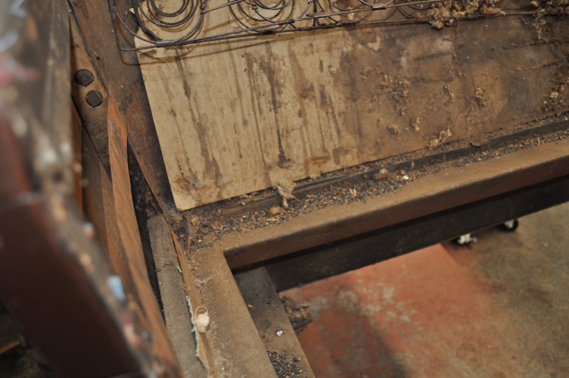

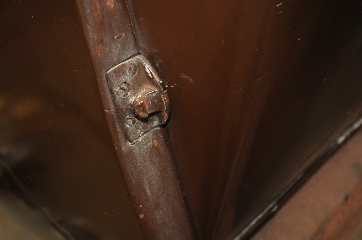

Steve, it depends which screw it is. The one photo is from the front seat looking back at the wood structure, you can see that there are two square nuts and machine screws close together. These are the backside of the striker plate for a 1293/24 touring. The other photo shows what it looks like from the front, suggesting that the two center ones are bolts, while the outer two are wood screws. I hope this helps.
