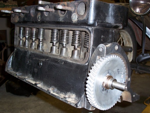

Post by MWalker » Sat Apr 20, 2019 9:00 am
Les -- I use Ford tractor valve retainers (part #8BA6514) with Chevy valves and Model T springs. They work great, and I like the idea of the more secure Chevy valve keepers in place of the T's "pins."
