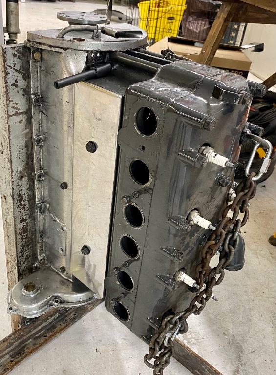

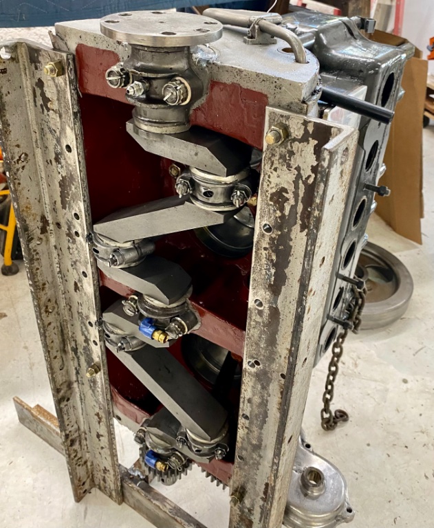

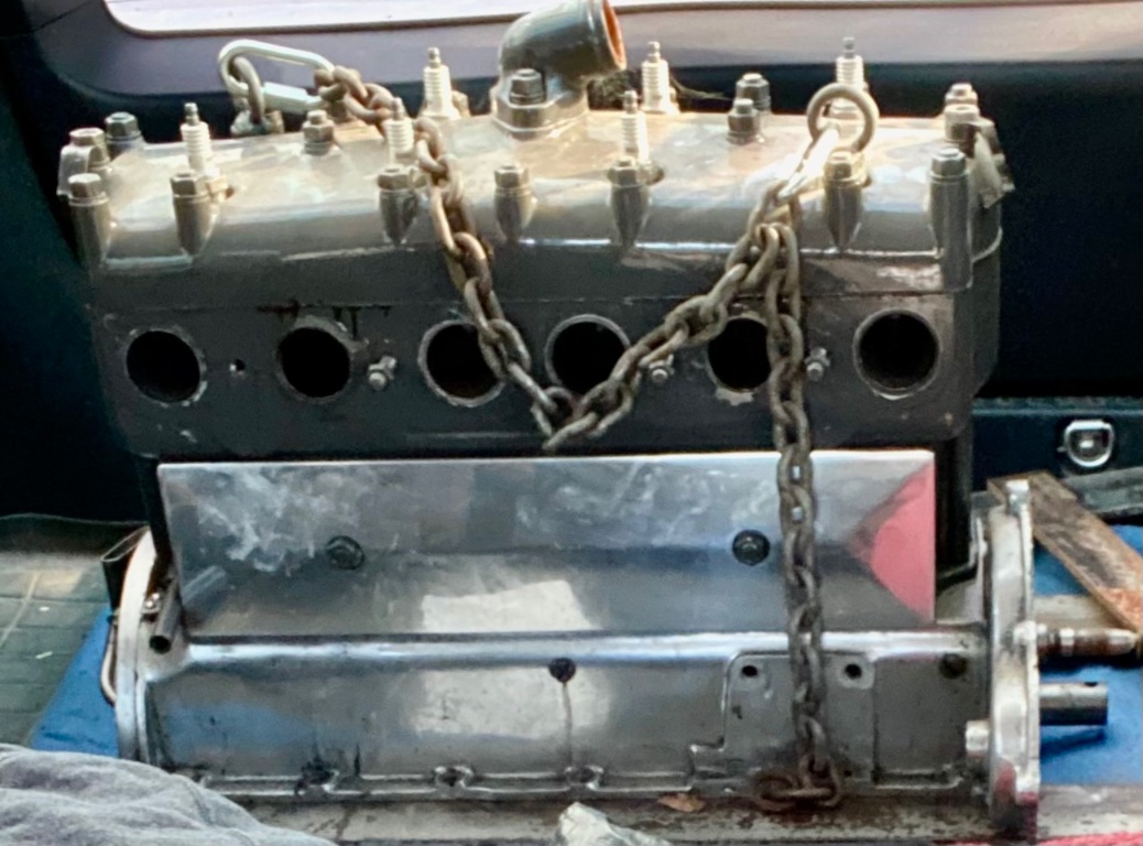

That's a really strong looking crankshaft in that engine!!! Imagine if they used one like that in Model T engines, maybe then we wouldn't have so many broken crankshafts now!

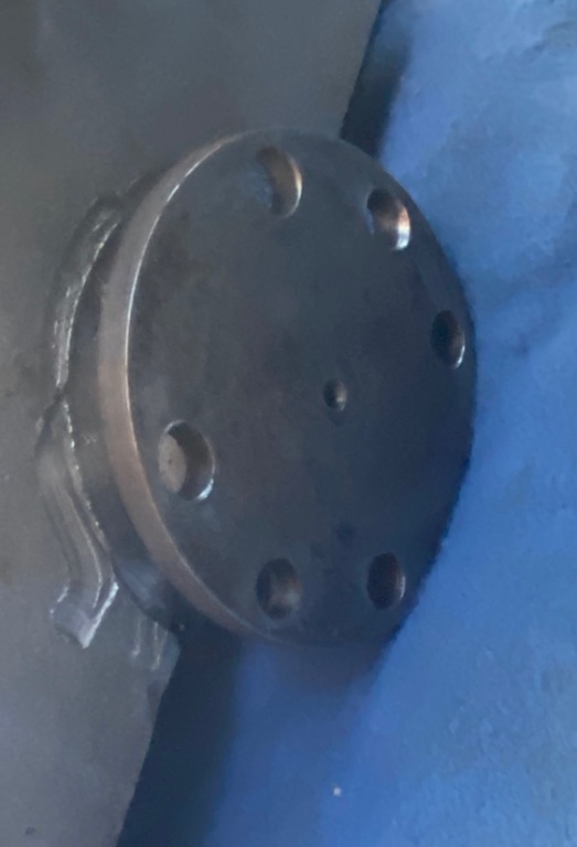

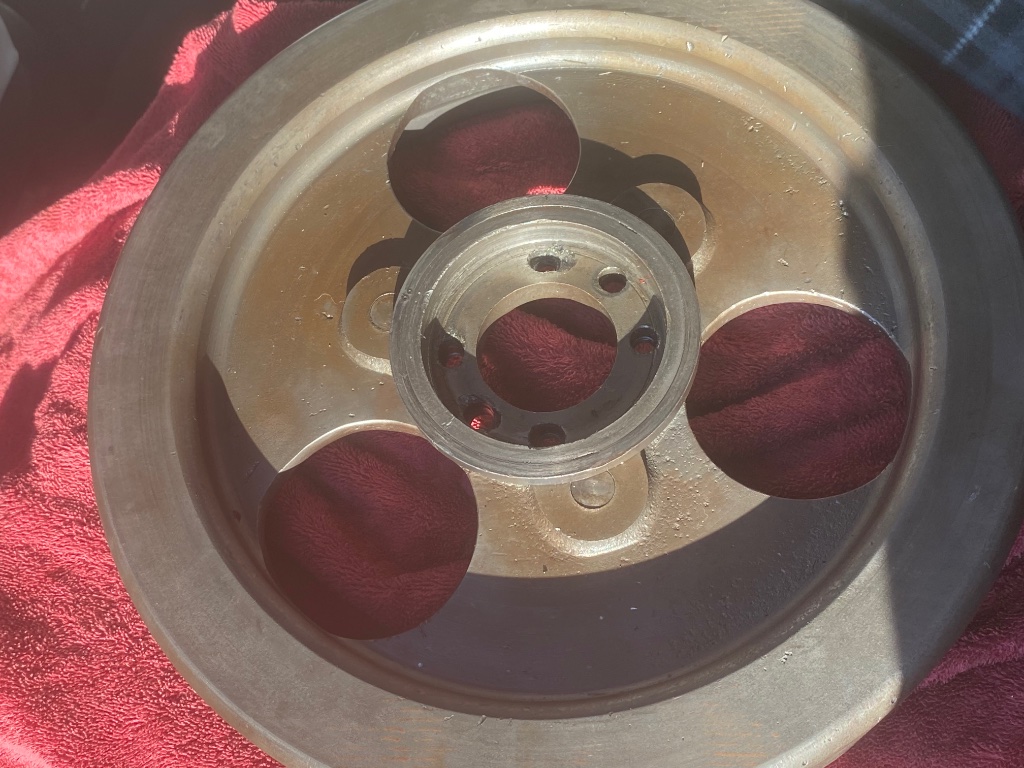

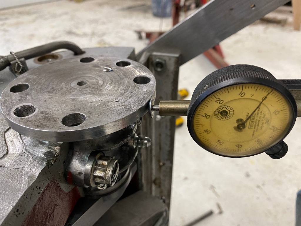

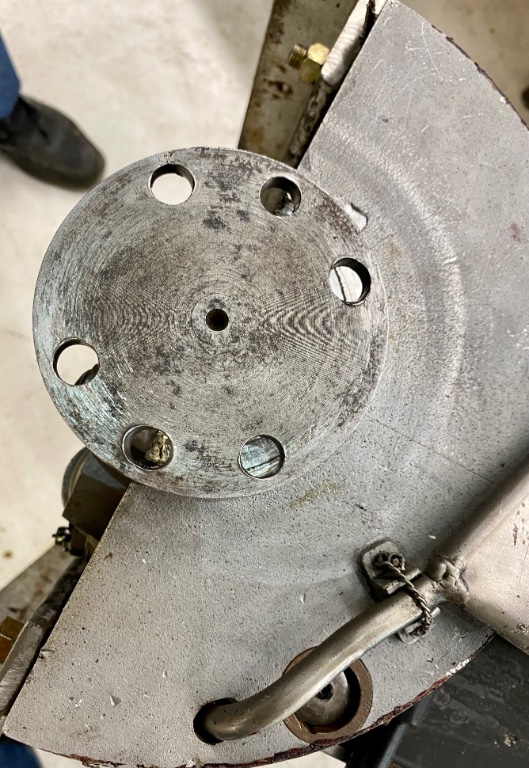

Rob, what’s the crankshaft condition as far as straight, and uncracked at the flange? Does it use through bolts and nuts? It’s hard to tell from the photos but it doesn’t look that bad. The dowel pins are worn, but reaming/boring the holes just slightly should work. Not unheard of to make a stepped pin with two different sizes on it. The bolts could also be custom made to be a tighter fit to reduce the shearing possibility. An interesting project. A very light facing of the flange could help too. I presume the end play distance isn’t too critical? Good luck!

It looks like the flange is ok, flat and straight. The flywheel threads were taken out, and a few bolt holes in the flange hogged out. It looks like we're going with a Model T flywheel, minus hardware. As Dean suggested, we can always add additional weight, or rebuild the original flywheel if we don't like the results.
