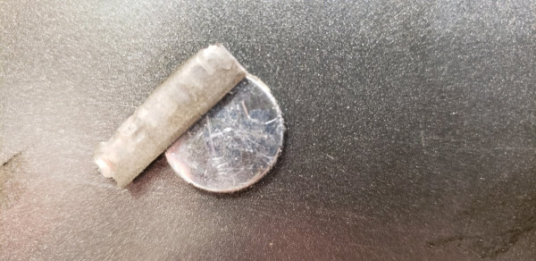

When I have done my last two oil changes I have found steel fragments attached to my magnetic oil plug. 3 or 4 in total. This image is the smallest of fragments its about 3/4" long (it is attached to a round magnet). All the pieces have been similar width and thickness, the others have been about an inch long. There has been nothing in the oil screen that has several rare earth magnets.
I have pulled the inspection pan and hogs head, visually without going any deeper everything looks normal. There was no issues driving. I have pulled the starter and generator, they look fine.
Any ideas of what it could be from? My guess at this moment, it could be clutch plates.

Brake drum lug.

Yep
brake drum lug...you can see the indentations along it's length from the clutch disks.
those are darn hard and if one finds its way to a triple gear, your annoying repair will become an expensive, extensive, annoying repair
a practical person would say that you're done driving this thing for awhile

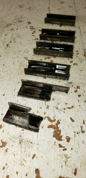

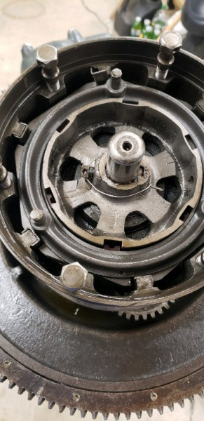

Thanks for the lead. Indeed damaged Brake Drum Shoes. It will be an easy fix. Just stood the engine on end and pull the clutch spring, and the six clutch plate bolts. Probably took an 1.5 hours, to devise a method to compress the spring. If I had the shoes in house we could have had it all fixed and put back in this evening.
Thanks again
FYI, I did find another large piece down in the bottom of the sump when we pulled the pan.

Re: Metal fragments in Oil
Post by Norman Kling » Sun Sep 25, 2022 12:44 am
Wow! Check all the gears for damage! It looks like you got lucky!

You didn't really need to remove the clutch spring. You can unbolt the 6 bolts and remove the driven plate (clutch plate) with the spring still attached. I know that it is too late to make a difference this time, but if you need to get into the clutch in the future you will know.

If you are going to do this, back off the 3 finger set screws as far as possible to minimize the spring's tension to minimize the damage to the threaded holes/bosses in the drum. Remove the 6 screws in an even manner. Last 3 opposing screws @ a minimum.
