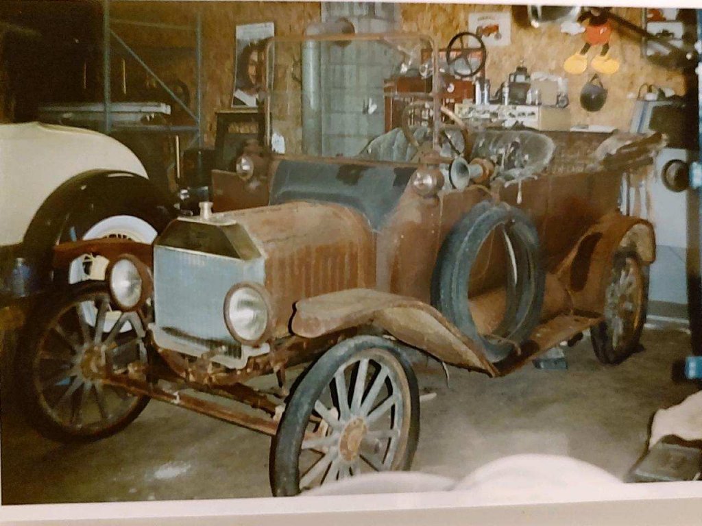

Here is what I did and where I am now. I removed the clevis pins and moved the brake leaver all the way forward. I had to screw the clevises in, about 1 1/2" to hock the pins up again. When the brake leaver is straight up the hand brake is on firm, I cannot push the car. I move the brake leaver forward a couple clicks and it is free. I drove it this way and it appears to run much better, not slipping the clutches. What do you think?
I attached the picture that was sent to me when the previous owner when he bought the T.
