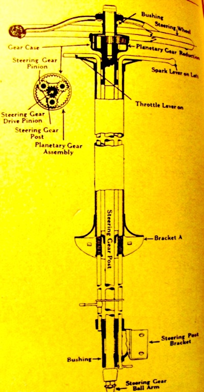

Follow the steps and photos in Ford Service, Chapter XXV, Steering Gear Overhaul. That includes removing the pitman arm ball, sometimes a gear puller is needed, sometimes just a lead mallet strike.
The timer lever arm has to be removed, by driving out the rivet, after that , just pull off the steering bracket from the shaft and the two rods.
IMG_7207 (500x375).jpg (79.51 KiB) Viewed 4362 times
Slip on the spacer bracket, that goes around the shaft and helps separate the two rods, then slip the new throttle arm up the throttle shaft, then be sure to index the arm so the long arm is pointed at the motor, with the lever at the quadrant moved all the way to the top. Rivet the arm to the throttle shaft, a small cut to length nail can be used as the rivet.

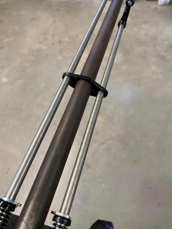

While he’s getting into this, I’ll ask a similar question. Does this black “spacer/divider” stay in place anywhere or supposed to end up somewhere along the length of the shaft? I reckon left to it’s own it’d slide down to the carb lever anyway…
Posts: 4460
Re: How Do I Install a Throttle Lever?
Post by Jerry VanOoteghem » Tue Sep 27, 2022 4:32 pm
fordt wrote:
Tue Sep 27, 2022 3:36 pm
Yup, and that's where it does its best work. :)

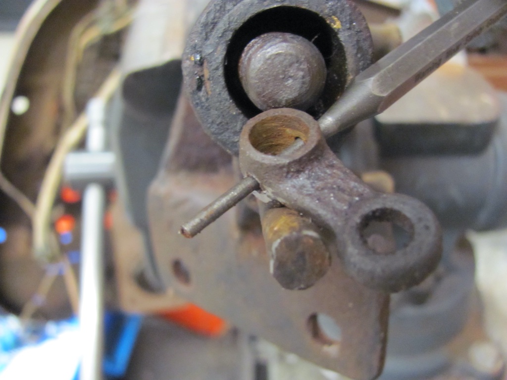

Post by Steve Jelf » Fri Sep 30, 2022 1:40 pm
With the spark rod lever removed as Dan showed, put the steering shaft in a vise and tap the bracket off with a drift and a hammer.
